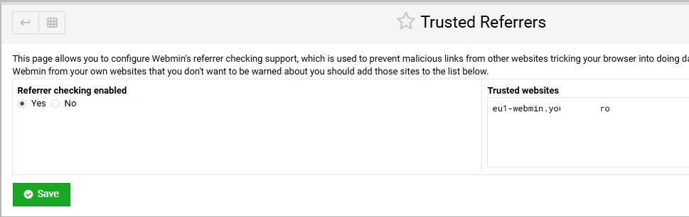

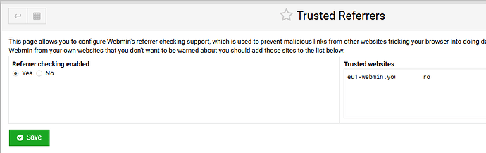

trusted referrers set to CF tunnel…that should be fine:

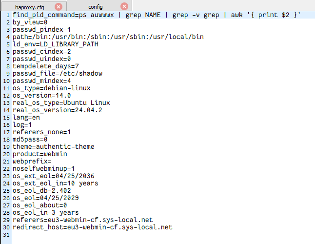

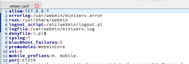

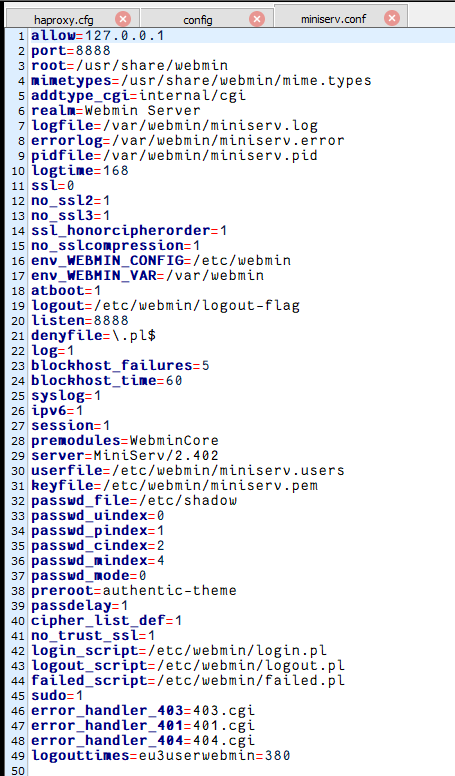

Hello @Ilia,
Just for interest, if you have any more ideas…
I couldn’t get it to work on our existing CF tunnels, we have remote mgmt. tunnels and in that state there is no local “credentials-file” , -but I put the suggested config in the remote config, but it still didn’t work.
So I created a test server on EC2 with HAProxy in front of everything… -exactly the same behaviour.
At first I thought it was the tunnel’s specialty, but HAProxy also causes this…
I made a video of this test system and here are the Webmin specific confs:
(I don’t hide sensitive data, because it’s just a test environment and in a few days it won’t be)
video (ZIP) :
