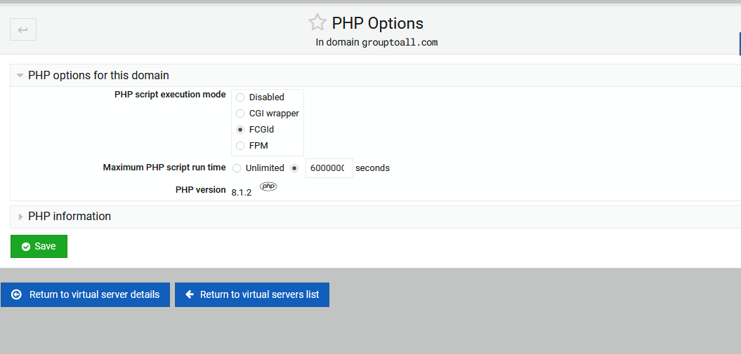

virtualmin not accepting correct php config file. This is my domain name https://www.grouptoall.com.Please check screenshot

I have no idea what you’re asking. What do you mean Virtualmin is not accepting it?
Please check the arrow in both screenshots.
The issue is php configure file is not correct with the domain name
What execution mode are you using?
This is clearly mod_php (Server API: Apache 2.0 Handler) based on your screenshot.
What happens if you choose FPM mode and click save?
Why does everybody keep installing mod_php!? We keep telling y’all to never do that, but every danged day we have a new problem caused by installing mod_php. (Installing mod_php creates a new configuration file that hijacks all PHP requests before the Virtualmin per VirtualHost configuration even kicks in, which breaks things in a variety of ways.)
