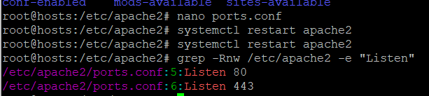

just change it to
Listen 80
Listen 443
just the 2 lines remove all other lines from the file and enable ssl & restart apache
from ports.conf I have to remove ?
Yes remove everything from ports.conf
it should read
Listen 80
Listen 443
and nothing else
done
Enabled the SSL from modules and restarted apache2.
now can i try creating a new domain in the virtualmin ? and see if php8 works !
Add apache is now running in ssl mode ?
