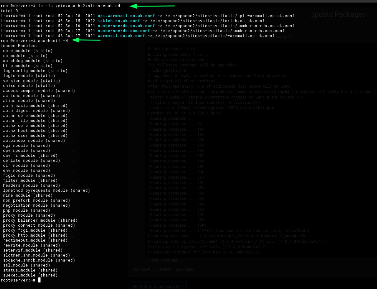

Whatever you have done it’s messed up apache2 you need to fix that. From the first screen shot that apache config file is missing try the following in a terminal
this will show you what apache has loaded & what virtual servers it is going to use.

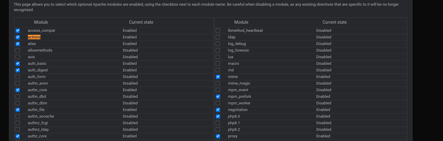

with mod_actions try
go to Webmin’s Apache Webserver module, click on Configure Modules, make sure mod_actions is checked, and then click enable
root@hosts:~# ls -lh /etc/apache2/sites-enabled/
total 0
lrwxrwxrwx 1 root root 35 Dec 10 14:24 000-default.conf → …/sites-available/00 0-default.conf
root@hosts:~# apachectl -M
Loaded Modules:
core_module (static)
so_module (static)
watchdog_module (static)
http_module (static)
log_config_module (static)
logio_module (static)
version_module (static)
unixd_module (static)
access_compat_module (shared)
alias_module (shared)
auth_basic_module (shared)
authn_core_module (shared)
authn_file_module (shared)
authz_core_module (shared)
authz_host_module (shared)
authz_user_module (shared)
autoindex_module (shared)
deflate_module (shared)
dir_module (shared)
env_module (shared)
filter_module (shared)
mime_module (shared)
mpm_event_module (shared)
negotiation_module (shared)
reqtimeout_module (shared)
setenvif_module (shared)
status_module (shared)
root@hosts:~#

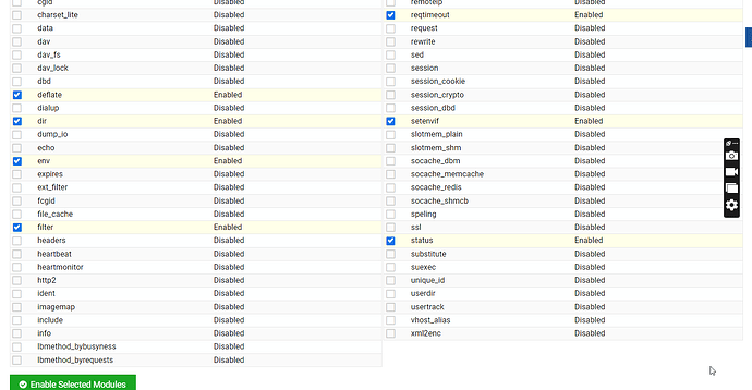

and make sure every module is checked that you need is checked and to be sure restart apache after that

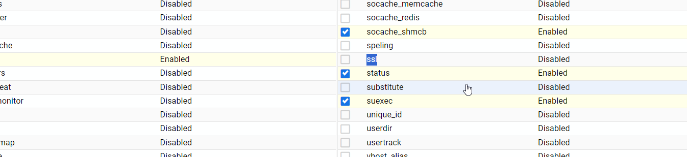

looking at what is enabled you will need to check ssl, suexec at least but check the list I sent you in the screen shot, its from a working virtualmin system so that should get you going

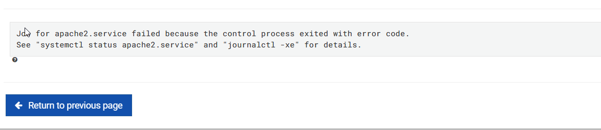

when trying to enable ssl and suexec
look at the error then to see what failed with
systemctl status apache2.service
or
service apache2 status
that will tell you where the error is

how to ensure php8.1 shows in apache module
You do not want to use mod_php you need to add fpm support to apache. Just enable it by
a2dismod php8.1
a2dismod mpm_prefork
a2enmod mpm_event
a2enmod proxy proxy_fcgi
a2enconf php8.1-fpm
This will get php fpm running with apache, then you need to configure your virtual servers to use it. If can restore the virtual servers this will do most of the work gor you as you will only need to disable php-fpm and re enable it via the virtualmin interface
