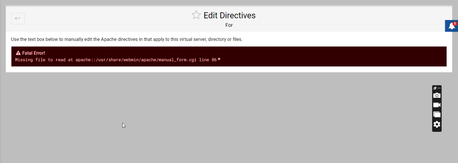

I installed apache again by deleting the virtual
Now php stopped working

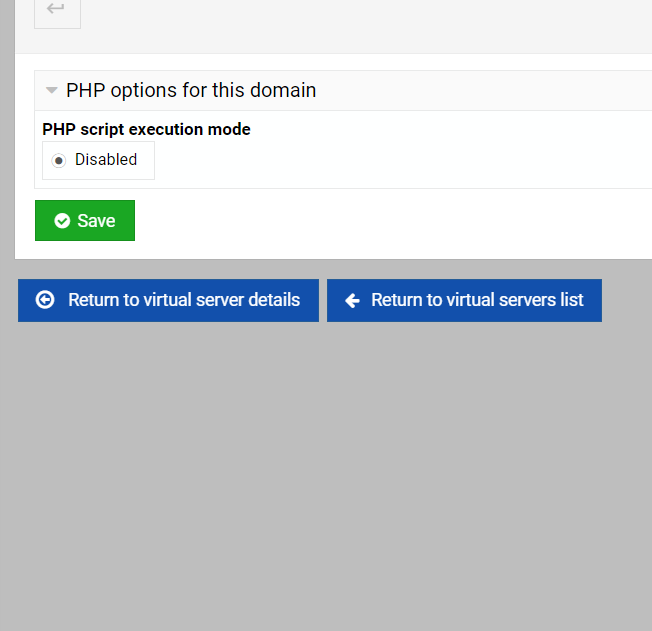

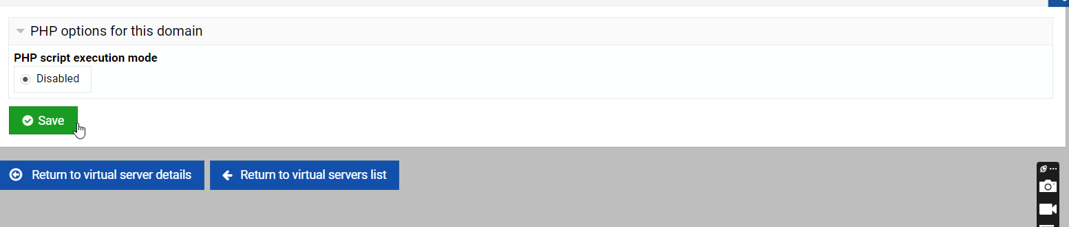

It shows disabled

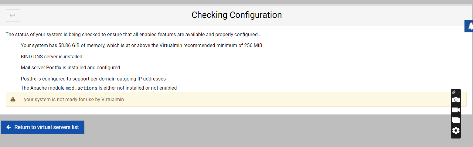

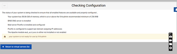

How can I fix this situation where Virtualmin works again with SSL
The execution options should be FPM or FCGId

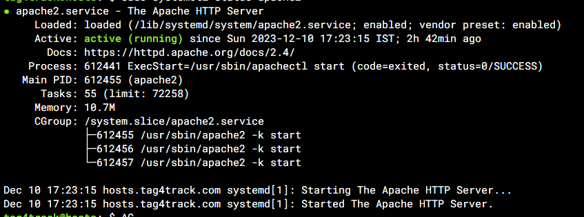

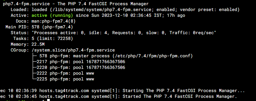

What os are you running ? What happens if you query the status of the php-fpm server does it show any errors ? The same goes for the apache2 server
Operating system Ubuntu Linux 20.04.5
Webmin version 2.105 Usermin version 2.005
Virtualmin version 7.8.2 Authentic theme version 21.09.5
And the apache server ?
Hmm just a thought have you enabled php-fpm support in appace as you have ‘reinstall ed’ apache
sudo systemctl status apache2
How can I check this ?
You need to make sure that in the apache domain config file that you are using the correct php-fpm pool file for the domain and ensure you have enabled proxy_fcgi in apache and also restarted apache. You say you reinstalled apache what commands did you use to do that ?

Going back to your post #3 in this topic, you indicated that PHP was “disabled”.
Going to Server Configuration -> PHP Options you should see
The execution mode should be set as FPM not “disabled”
That makes no sense!
On a new install of Virtualmin I have never seen that.
I am pretty sure the failure to show the execution modes has nothing to do with Apache @staff could confirm that.
