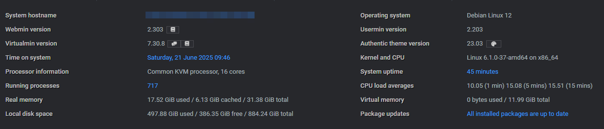

Which versions of Webmin and Virtualmin do you have installed?
