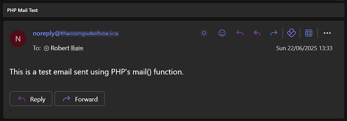

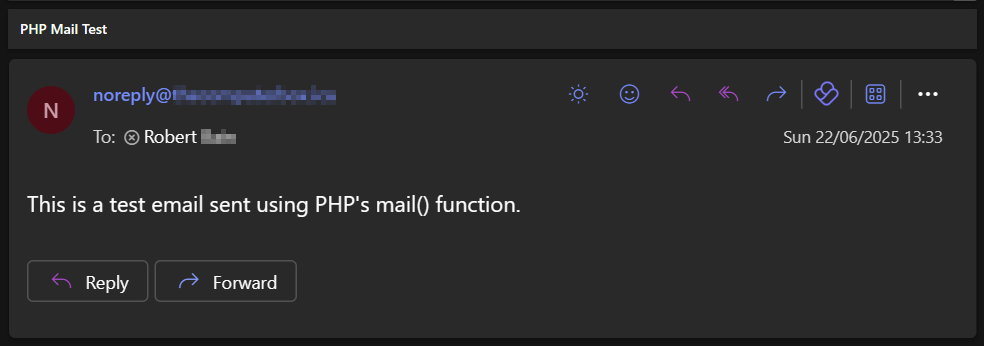

I can now send emails from wordpress fine and my test script.
The correct from address us used as well from the sendmail command ignoring the one in the config file.
