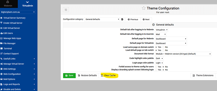

It could be cache, try clearing it.
Unfortunately, clearing the cache has no effect.

Patch applied, cache cleared, server restarted.
