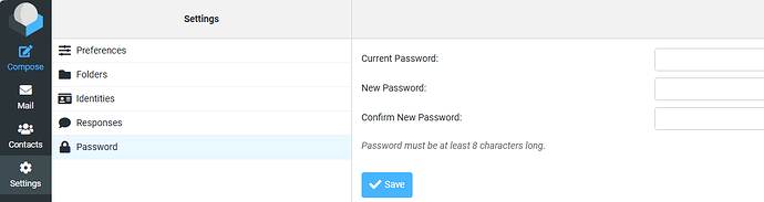

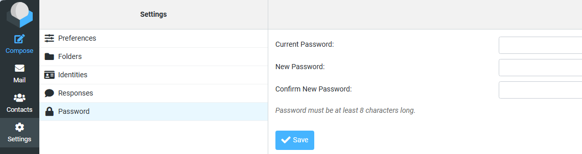

Which gives you this:

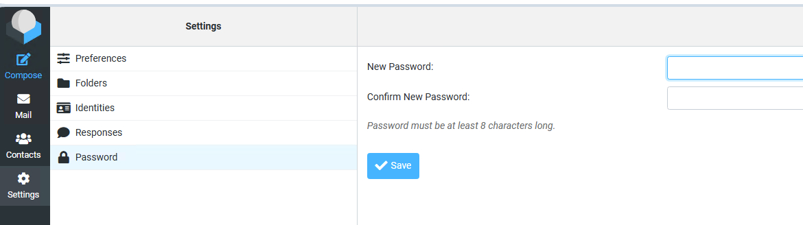

Note that his adds confirmation of the current password to the form:

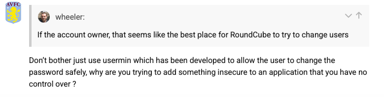

Don’t bother just use usermin which has been developed to allow the user to change the password safely, why are you trying to add something insecure to an application that you have no control over ?
