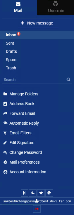

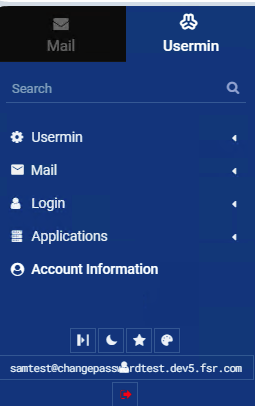

My users would be instantly confused by the tabs at the top though (those lists should be combined, and most of them hidden or folded up as a “Settings” button somewhere, and that top corner should really have nothing, save maybe a logo), the Search button that searches settings not mail will confuse users no matter where it is, so will the Folders which name their type (which users won’t understand) (“Auto-Clearing” is awesome, “Copy” seems dangerous), only the amount of space and maybe system time is appropriate under “Account Information” (but the rest of this list looks pretty good (if more “adminy” than “warm fluffy usery”, but again most of these should really be under a not-usually-looked-at “Settings” thing in my view).
The Usermin tab contains that same “Account Information”, duplicates of the filtering and auto-replies but with different label names, it adds scheduling emails which is kind of cool, but gives users access to SpamAssassin which I am included to not want them to have (we handle that 3rd-party on the way in now), has the same password change (named differently) and has only one Application, “GnuPG Encryption” which I don’t understand myself so don’t relish trying to correct some thing a user broke in theirs. I would be willing to sacrifice “Scheduled Emails” not to see the tab at all.
You helped me before with obscuring some of the things I am listing, but the tabs just won’t make sense to civilians in my imagination (they will only know the address to go for webmail, the rest they have to intuit and while any admin can intuit this, users used to gmail.com and outlook.com will not).

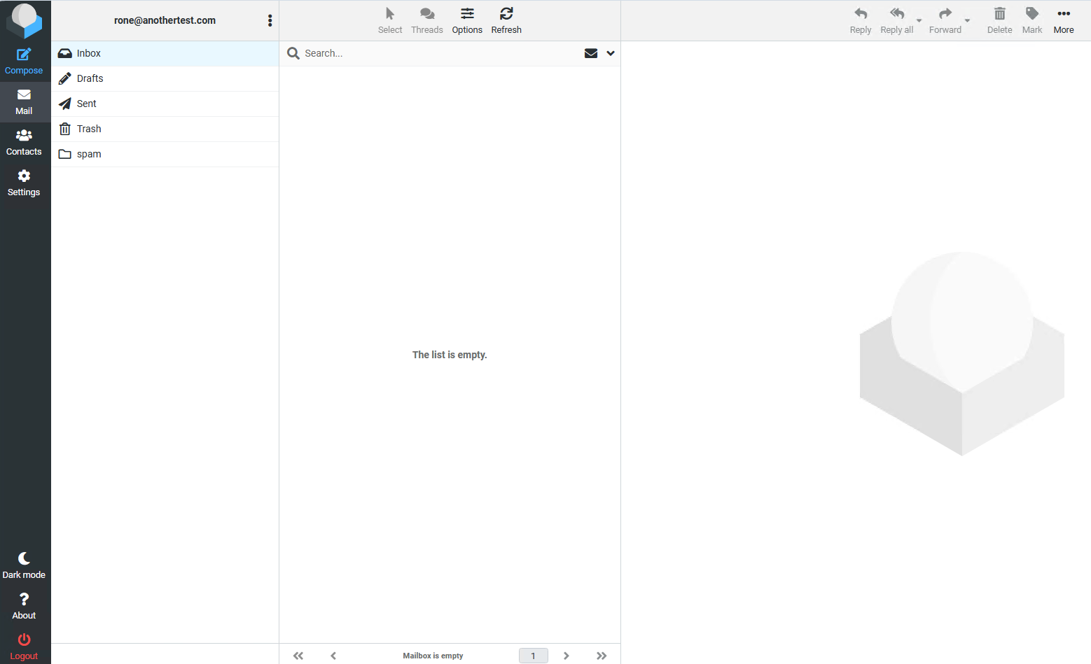

Out of the box Roundcube is not a bad template:
And as a totally informal and admittedly unscientific test, I logged into a test account which has a single email in it using the 20000 address, and counted to “1-Mississippi, 2-Mississippi, 3-Mississippi, 4-Miss” before I was authenticated and looking at mail. I counted to “1-Mississip” using Roundcube on the same account.
This was using Opera. I deleted the browser history, cookies, and settings and then closed and opened the browser between tries, and I repeated the test with the same result (ruling out server cache).
My Roundcube is on :80 (no SSL) so that might account for it, and of course just those couple of seconds don’t necessarily translate to a significantly slower user experience, but it is worth noting.

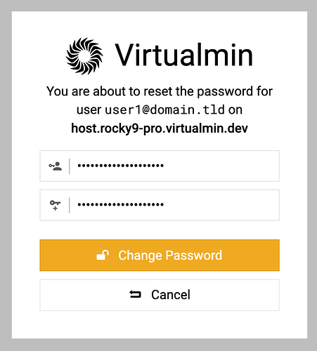

Why would you want any of that complexity when you could simply reset the mailbox user password (if implemented) using the login page, e.g.:
