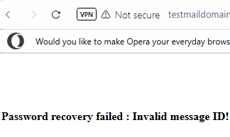

Webmin Virtualmin Password Recovery
I installed this:
sudo apt-get install webmin-virtualmin-password-recovery
If I choose the “Email random temporary password” option I get this when I try to use the resulting link:
Password recovery failed : Invalid message ID!

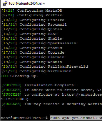

Sorry for the delay, I had a few things this week, and thank you for taking an interest in this.
To retest this with minimal chance for “something I did”, I installed:
ubuntu-24-04-2-live-server-amd64.iso (the latest) from ubuntu.com and did no updates.
I ran the virtualmin install, I logged in and went through the configuration wizard (only changing passwords to plain-text to confirm that that part does work, if needed), otherwise all defaults.
I added a test domain and a user to that domain.
I installed the plugin.
This server’s entire command line history to that point looks like:

I went to :20000 and clicked the forgot password link.
I cat-ed the only piece of mail in /home/thisisatestdomain/homes/thisisamailuser/Maildir/new and copied and pasted this:
https://thisisatestdomain.com:10000/virtualmin-password-recovery/email.cgi?id=3D02522c4fbf049a85511636a7a52d167a
(I confirmed that such an id/file, not including the 3D, exists at /etc/webmin/virtualmin-password-recovery/links, I even chown -R 777 /etc/webmin/virtualmin-password-recovery in case it’s just a permissions problem.)
I then changed the domain to the internal IP (as I do not control that domain) and got the same error and the same miniserv.error lines. I then added that domain to my hosts file, emptied my browser cookies/history/etc restarted the browser and visited the link as pasted. Same error.

It adds nothing when I click the link that tells me invalid message id.

I believe that I misrepresented not having DNS before. Virtualmin is making the DNS as per its out of the box setup, the outside world points nothing to this, but this mail does not go to the outside world.
You have said that I shouldn’t be installing ubuntu from ubuntu.com. From where then? Your examples have me installing a favorite VM whether into a cloud host, a personal computer, or a dedicated computer. What makes this favorite VM special and where do I get one (does Virtualmin happen to have pre-configured “appliance” that I can just attach and expand for example)?
What OS and version is working for you?

An apt update and upgrade is fine. It won’t harm anything. We just don’t want a bunch of random extra packages installed and/or configured.
I don’t know who said that. If you’re installing on your own hardware, installing from an ISO downloaded from the Ubuntu servers is 100% fine. That’s literally how we test.
Pasted into where? Your browser on your PC or a command line for curl on the same console you did the cat?
The id is getting lost. There must be an explanation for this. One explantion is that miniserv in Virtualmin is redirecting without appending the id.
No problem with that. It is the default.
Version 1.12 is the fixed version. I don’t think it is a Perl issue. If it was it would show up elsewhere also. There is nothing special or out of the ordinary to justify that it is a Perl issue

I see the port below is 10000. There is no need for a redirection.
So Minserv on port 20000 (Usermin) is not redirecting to miniserv on port 10000 (Webmin/Virtualmin) without appending the id.
It does not make sense for miniserv on port 10000 to redirect when the required cgi is fully specified:
This is my explanation.
You have more than one instance of Virtualmin running say on server exampleA.com and server exampleB.com
You are generating the password reset on exampleA.com
You have an entry in an /etc/hosts file that has not updated the IP address for exampleA.com (it points to exampleB.com)
OR
The password rerset URL specifices exampleB.com, not exampleA.com
