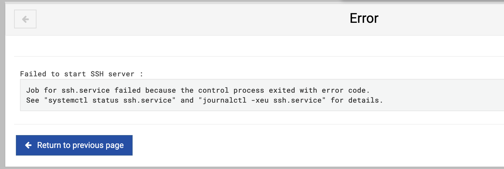

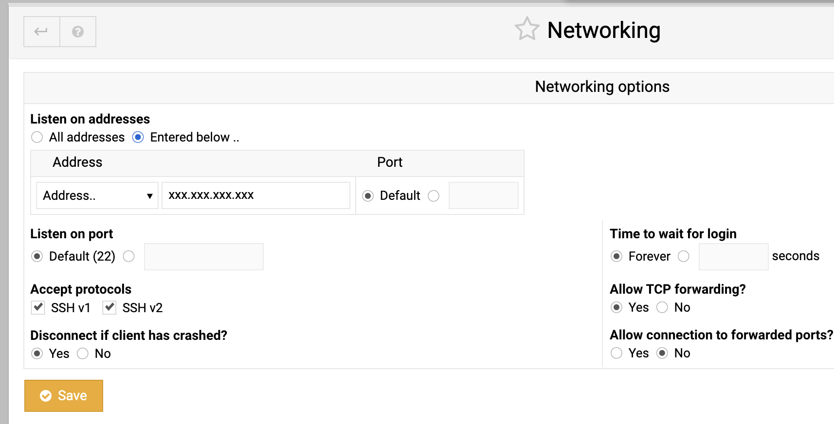

I would like to restrict SSH access to specific IPs (and later port)
On the Webmin, Servers, SSH Server, Networking panel and I set “Listen on addresses” to my Ip address to start with.

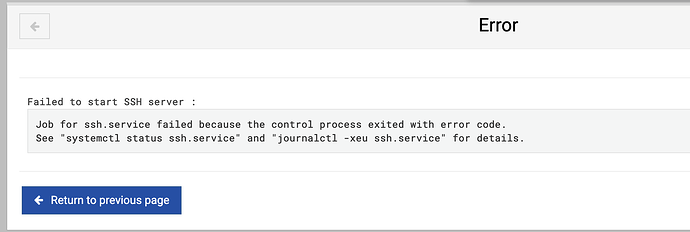

I apply the changes or restart the SSH Server but it fail to start with the following error:
And here the logs:
Jun 24 11:02:37 xxxx systemd[1]: Starting ssh.service - OpenBSD Secure Shell server...
Jun 24 11:02:37 xxxx sshd[231251]: error: Bind to port 22 on xxx.xxx.xxx.xxx failed: Cannot assign requested address.
Jun 24 11:02:37 xxxx sshd[231251]: fatal: Cannot bind any address.
Jun 24 11:02:37 xxxx systemd[1]: ssh.service: Main process exited, code=exited, status=255/EXCEPTION
Jun 24 11:02:37 xxxx systemd[1]: ssh.service: Failed with result 'exit-code'.
Jun 24 11:02:37 xxxx systemd[1]: Failed to start ssh.service - OpenBSD Secure Shell server.
Any idea someone ?

MMM… I understand your explanation of course but the interface is quite unclear about this as it allow to select:
  • ALL IPs
  • ALL IPv4
  • ALL IPv6
  • Address (what I’m trying to do)
And the port can be also assigned so… So my first thinking was it allows restricting IPs (any).

That’s “any local address”, which translates to 0.0.0.0 when binding to an address.
