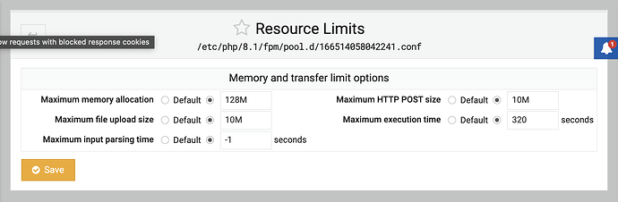

@masterg0g0 For the Maximum execution time (i.e. max_execution_time) to work as expected, you should set Maximum input parsing time (i.e. max_input_time) option to -1 in Services ⇾ PHP-FPM Configuration: Resource Limits page.
@Jamie, for PHP execution time to work properly, we should set max_input_time to -1. I think you considered it back in time, and this is still what the default should be according to the PHP documentation, but it appears that it’s not, and the default is set to 60.
I suggest that every time we change max_execution_time using PHP Options we set max_input_time to -1 as well.

Try using UI to change settings in Services ⇾ PHP-FPM Configuration page:
It should be written as:
php_admin_value[max_input_vars] = 6000
