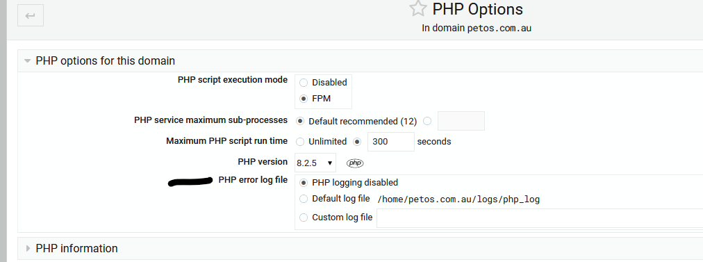

the template should show it being enabled
Unfortunately, it doesn’t. It just shows what was in my first message. If I try to enable it, then it errors out and reverts.
2-PHP-Optioins
because its complaining about the error log, when you set fpm are you disable logging before saving?
it maybe a workaround, but maybe you tried that?
And when I refresh again, it shows up. How weird is that?
No I wasn’t able to set logging at all on the system when FPM was disabled. The image in my original post was the entire panel available to me for the PHP options. There was nothing else. I could either set PHP to disabled or to FPM, but no FPM options showed. I figured they would after I had saved the setting.

cool, i was going suggest to install 8.1 as well and see if behaved the same way,
Thanks for going through it with me. I’m not sure what changed, but I’m glad it did so…
