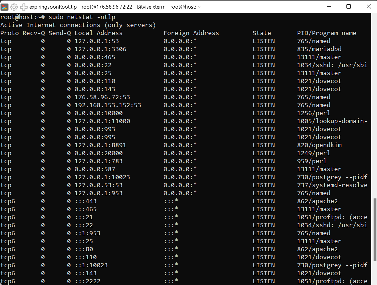

sudo netstat -ntlp
gives me this

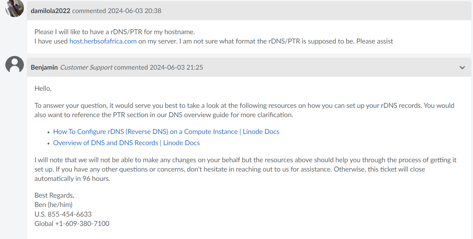

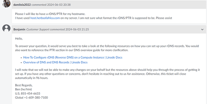

Response from Linode about rDNS/PTR is this. Looks like I might have to set it up by myself.
Follow the instructions they give you and ask if your port 25 is fully open for your email server.
Other than that, you can’t really do anything until that port is open to the public and shows open from our end.
