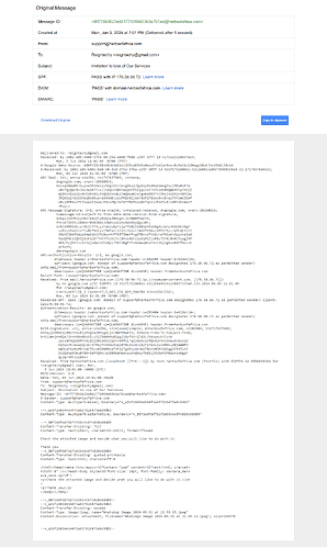

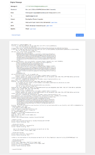

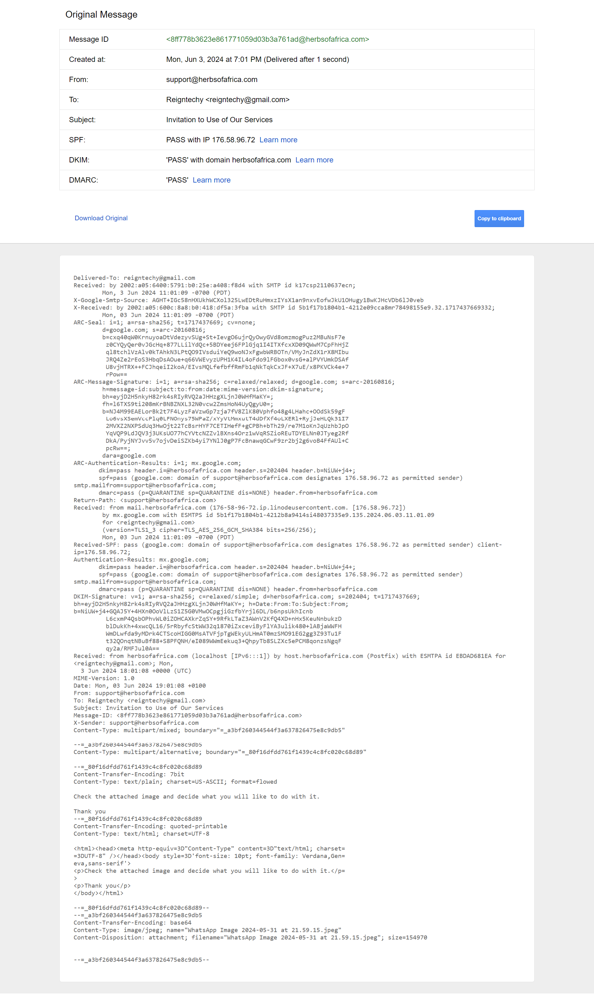

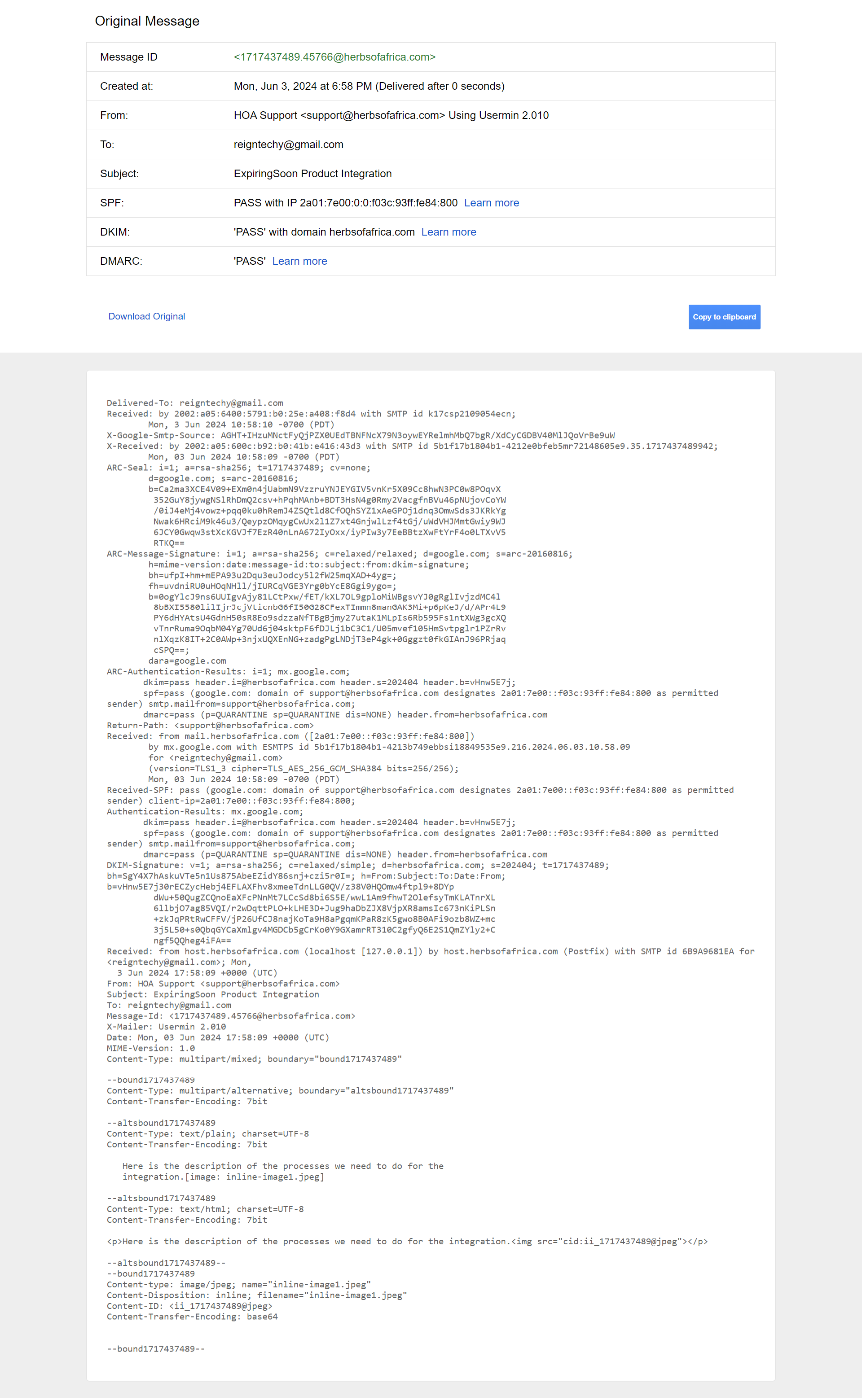

Look at the headers of both of the sent emails and see how they differ this may shed some light on what’s happening. There should be some diagnostics there
This is the original of the image sent from usermin
This is the original of the image sent from roundcube

This email is using your servers ipv4 connection which I assume has a rDNS/PTR record with your provider.
This email is using your servers ipv6 connection and perhaps doesn’t have a rDNS/PTR record? That will land it in the spam box of google.
  1. What should I do about this? How can I use only ipv4
