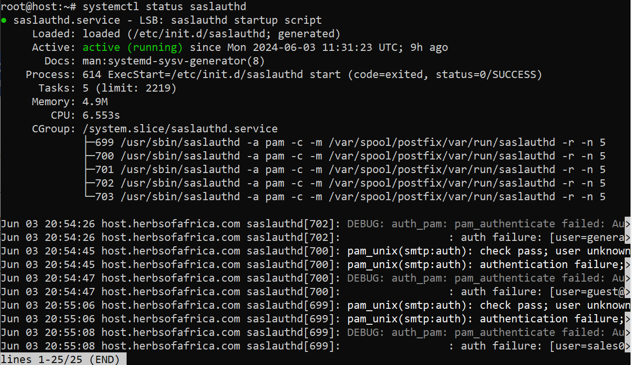

That will have no effect on SASL authentication.

After taking another look at this, I can confirm that no restrictions were in place on your service. We had made a mistake on our end when asking for that relevant information. With that in mind, the likely issue lies with the internal configuration since we are not blocking your SMTP ports.
Our ability to troubleshoot this from our end is limited since we do not access the internal configurations of your services. However, we do have some valuable guides on how you can troubleshoot from your end. I will provide those below for reference.
They are having issues with their SASL connection because their script or client is not set up properly to connect to their email server. They are using mydomain.tld and not mail.mydomain.tld
@reigningking I had already mentioned above that your settings for your script is not set up properly.

The title of this thread starts out with “Cant connect SMTP” but he had already shown above that his email had left the server through port 25. Yes, my mistake for not finishing my sentence about his script not being set up properly for SASL Connection. My apologies…
You’re trying to solve the wrong problem. As I said, port 25 has nothing to do with SASL authentication.
I identified your problem above (Cloudflare, your problem is Cloudflare): Cant connect SMTP - #40 by Joe
And cyberndt has also provided a solution to that problem (use an address that is not being proxied by Cloudflare).
You need to focus on one problem (and I need you to focus on one problem). Port 25 is unrelated to your SASL authentication problem, so let’s forget about port 25 for this thread.

My Virtualmin Notes | QuantumWarp
The config file is
/etc/postfix/sasl/smtpd.conf
Verify/Test SASL authentication
testsaslauthd -u username -p password
testsaslauthd -u username -p password -s smtp
  • “-s smtp” argument is required if you have set “pam” driver for saslauth, you need it.
  • Virtualmin uses pam driver for user authentication, but it passes credentials to authentication mechanism over smtp.
It’s all there! From top to bottom… Don’t know why everyone continues to ignore it…
@reigningking Please read my last post to resolve your issues…
