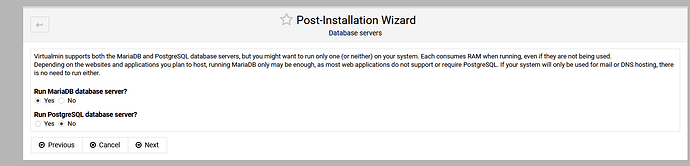

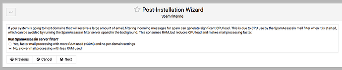

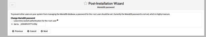

I have now repeated this with a purpose-made out-of-the-box install (on Ubuntu 24.04).
I took screenshots of every step of my configuration (in case any of the choices matter).
I also took screenshots of creating the virtual machine and user but I’ll spare you most of those. I also repeated the login test on Edge (photo is Opera).
