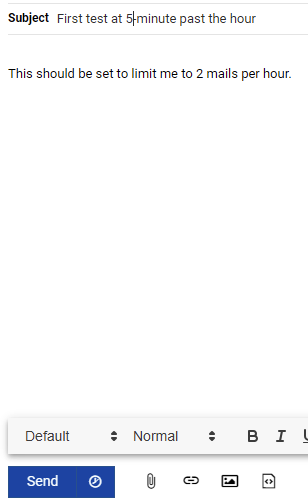

I set my single test domain to allow at most 2 mails per 1 hour. I logged in using a fresh browser on :20000 as my test user. I sent three mails, two minutes apart, beginning 5 minutes after the hour (in case it resets on the hour) via usermin’s webmail to three different email addresses (each one at a different domain), and all three arrived in their respective inboxes.
If I am not mistaken the last should not have arrived and I should see an “exceeded” message somewhere in the log and not the status=sent (250 Message queued) from the receiving mail server that I do see.
