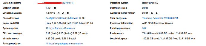

I use Rocky 9 and I have no issue. Just to double check your virtualmin machines (not server) settings you see this.

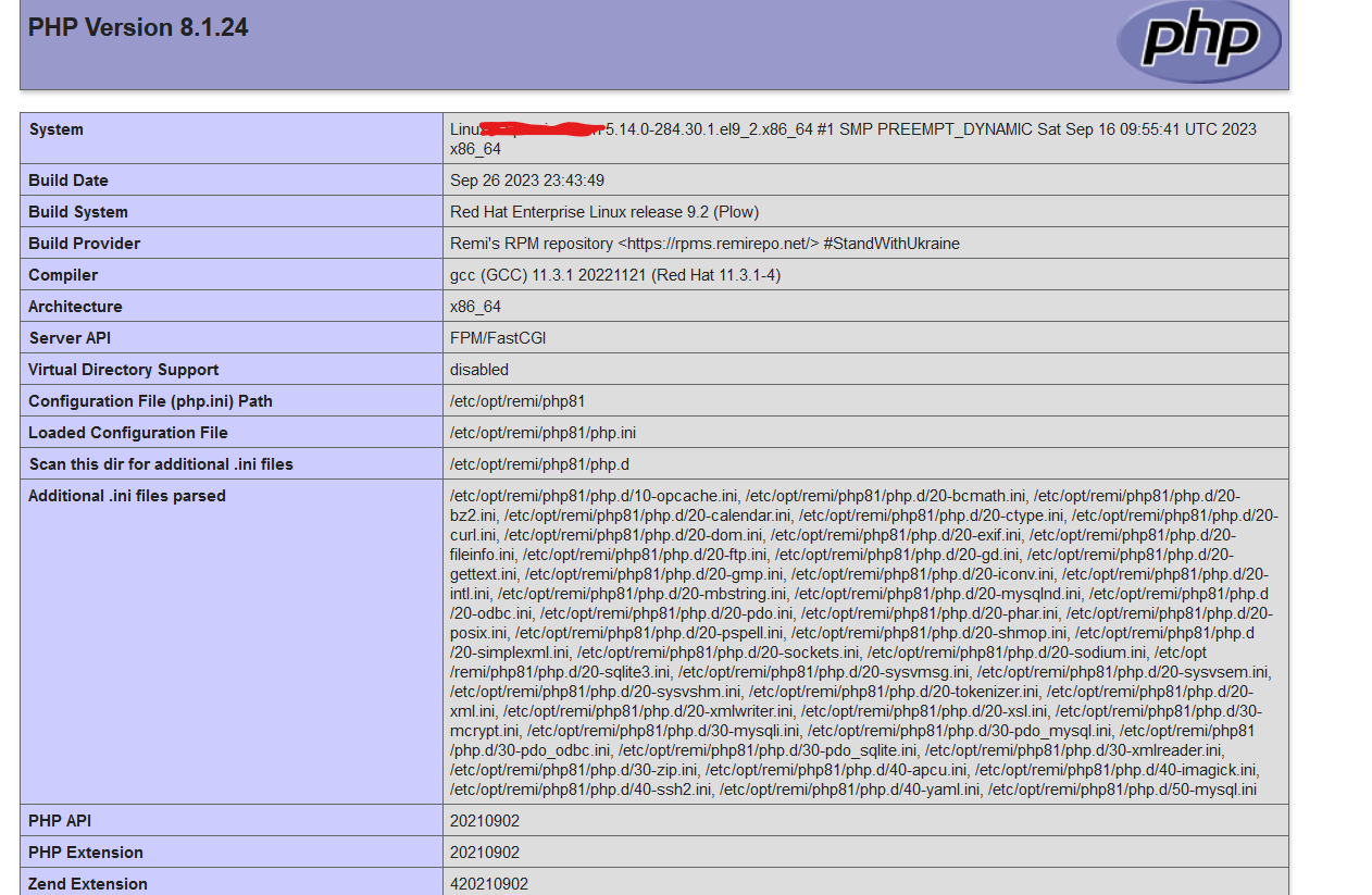

and the php info from the highlighted.
yes same settings
