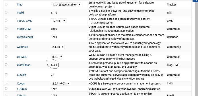

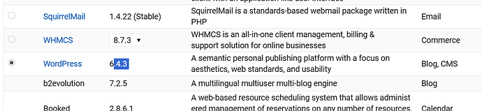

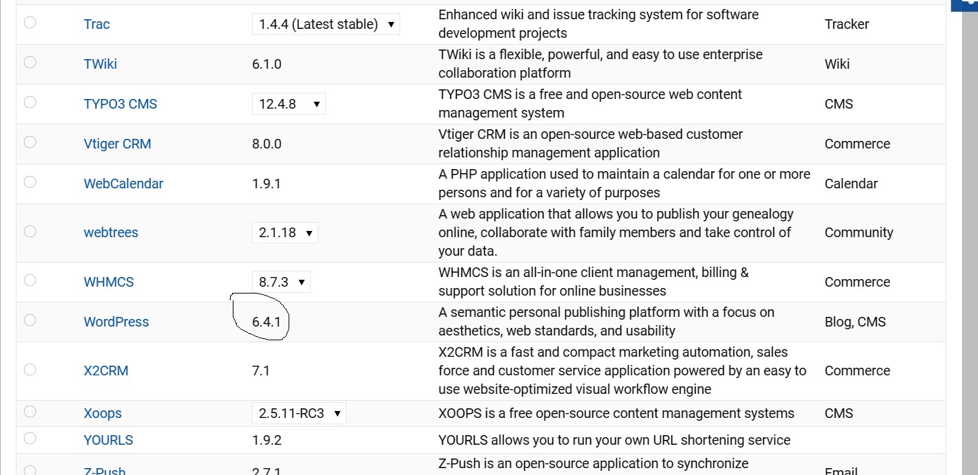

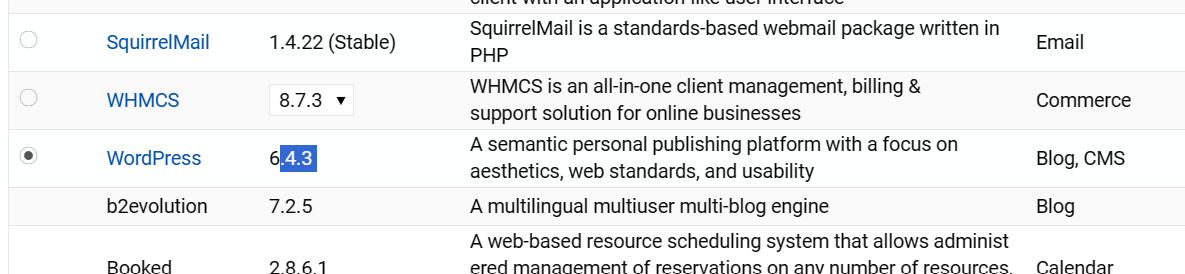

I saw that Virtualmin went back to Version 6.4.3 and was on version 6.5 of wordpress.
I have the latest virtualmin installed and all the instances installed show 6.4.3

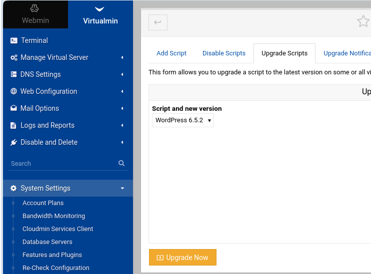

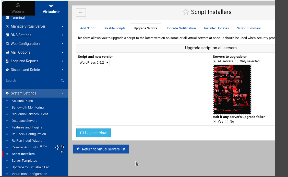

The install scripts are automatically upgraded, usually within 24 hours. Though you could manually trigger scripts upgrade in Webmin ⇾ Webmin Configuration: Webmin Scheduled Functions page.
There is no difference between the GPL and Pro WordPress Install Script. Either will update to the latest version automatically within 24 hours as long as you haven’t disabled script updates (and don’t block those downloads with a firewall or whatever).
Hello This brought the version to the latest but still get
wp core download failed : Downloading WordPress 6.5.2 (en_US)… Error: Couldn’t access download URL (HTTP code 429).
