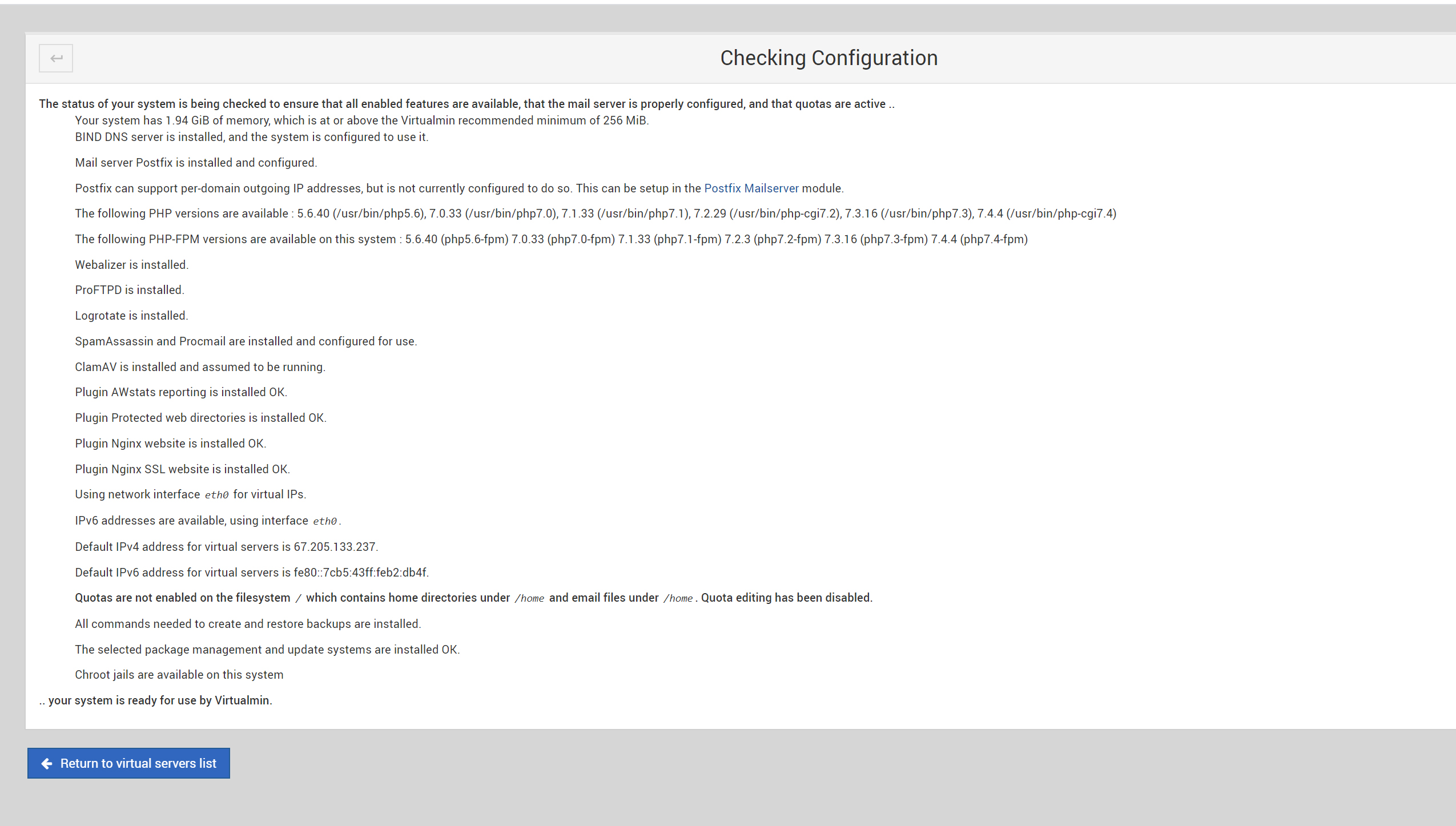

Here is the PHP versions page
Here is the Configuration Page
