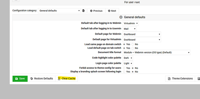

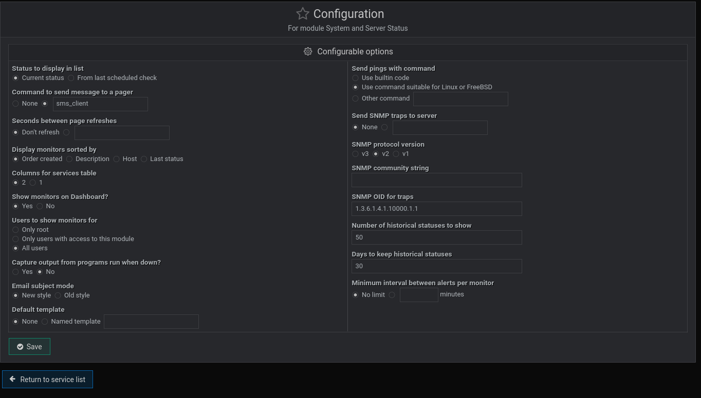

I have the status options set like this
The dashboard looks like this
As you can see I click the dashboard tab (arrowed green) and following your instructions from months ago I have been clicking the icon arrowed in red, which I what you told me to do. No matter how many times I click the icon nothing changes, is this the correct thing to do ? If I now install the virtualmin module the server status appears and remove the virtualmin module and the status disappears

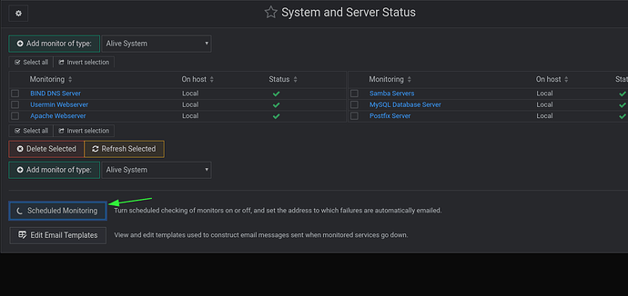

The problem is that for this feature to work you need to enable Scheduled Monitoring in Tools ⇾ System and Server Status page.

Ok did that
  1. Webmin only system still no System monitors or Server Status accordions
  2. Webmin with virtualmin module installed Server Status accordion only
  3. Virtualmin full install everything still works as expected
You need to wait a little bit until the scheduled function kicks in.
Actually, after taking a closer look, it appears that the default scheduled collect info isn’t enabled by default, even though it shows as enabled in Webmin ⇾ Webmin Configuration: Background Status Collection. For all this to work now, you need to toggle the Collect system status in background? option.
