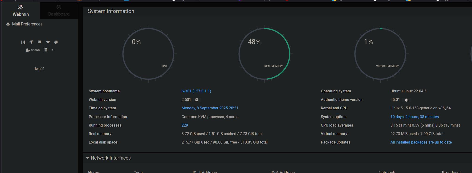

Webmin 2.500 side bar menu disappeared after upgrade
Just an observation from the behavior. What does “saving” on the Theme Configuration do that the Webmin Server Index call to the server doesn’t do? As I indicated prior when I click save in Theme Configuration all the menus come back.

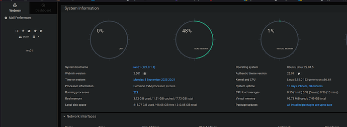

Just to be sure. The same picture, but with Firefox and without any add-ons ?
That will take me a little bit. Stay tuned.
Looks like this is a bug in Webmin 2.5 since the menu comes back after saving the theme but doesn’t stay. For now, re-saving the theme is the best workaround. 2.5.1 hasn’t been officially dated yet, but it should come out in a few weeks.

Could you please explain what the issue is? It would be helpful if you could share a screenshot of the problem and describe the steps you took.
Also, could you provide the theme config files from /etc/webmin/authentic-theme/settings.js and /etc/webmin/authentic-theme/settings-root.js? I remember that the theme config you mentioned worked after saving it, so I’d love to see those files. Thanks!
@jet438 @sdsheridan At last, I’m also curious to know which browsers you use and on which operating systems? Also, are you friends by any chance—I thought that maybe you use similar browser extensions? Those could be the culprits behind the issue; I suggest trying a browser without any extensions enabled. The latest Chromium would probably be the best choice for an unbiased test.

Server reached via Webmin’s server index:
No navigation menu when first accessed that way. Only upon going into theme settings and simply saving does the side nav appear as it should. Steps to recreate are to simply click on the server icon via that index in the base Webmin instance, or alternatively choose from the dropdown of available servers. Either way, it’s the same.

Using firefox here on Windows 11. That said, tried in in Brave, got the same result, as well as in Edge.

I also spun up a fresh Kasm Chromium workspace and checked one of the affected servers. Same result with Chromium.
