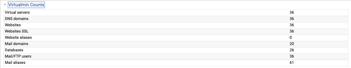

When you say domains do sub-domains count?
Example:
Does sub1.domain.com, sub2.domain.com and sub3.domain.com count as 1 or 3 domains?
Here are the counts on the Virtualmin (GPL) server in question:
There is an free version, which is what I installed and tested on a seperate, non-Virtualmin, server:
Yes, top-level domains and sub-domains count, aliases not.
