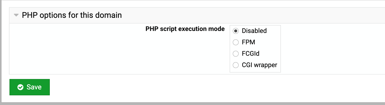

I am at a loss. I realized that apache2 is not running as domain user. in my Apache sites-avail conf files, it is configured for SuexecUserGroup correctly. There are no errors Suexec in apache at all, however when checking phpinfo() you can see that it is running a www-data
I have looked all over with another server that is running debian 11 and running correctly. I cannot figure out why I can’t get this running as the domain user.
I have also noticed that I cannot get this server to switch php versions. Something does not seem to be working correctly. I can’t find any logs files to point me to anything.
in php options I have it as FCGID. I do not know how many times I’ve switched exe modes and tried them all like FPM but nothing seems to changes. I know I need FCGID or FPM. Switching php version does nothing.
Is there anywhere I can check in webmin to understand why I cannot get this to work? I cannot find any difference in configuration of apache2 from a working server with virtualmin and this server.

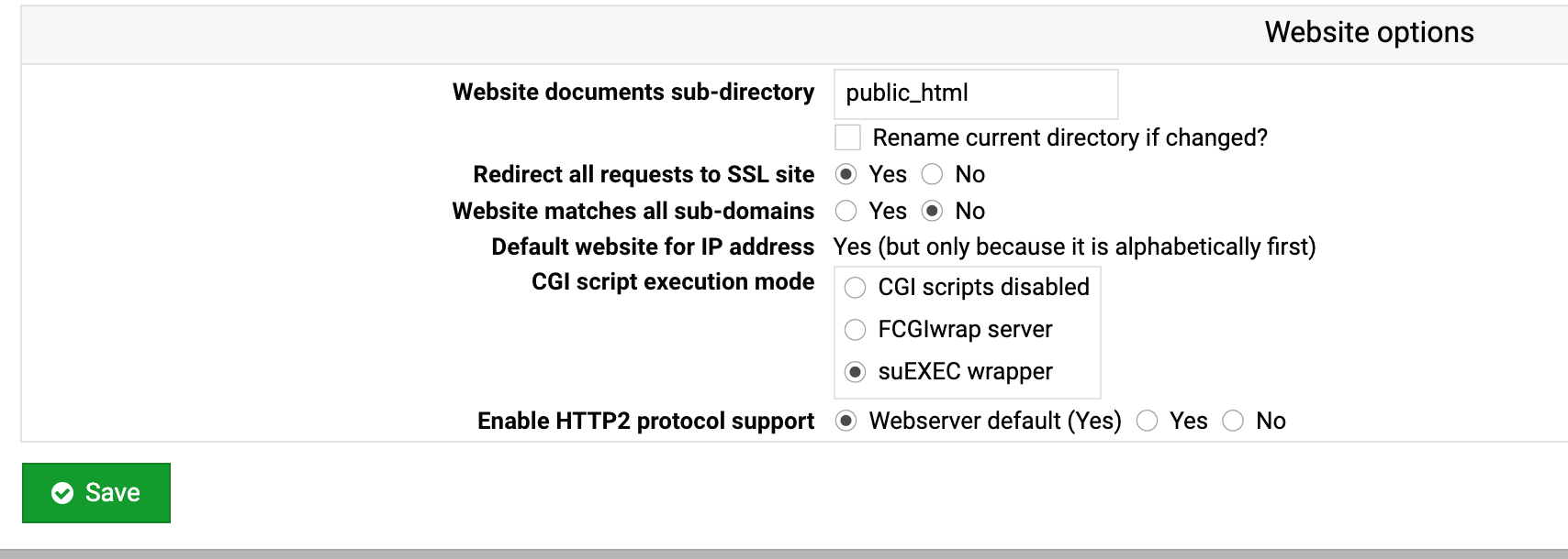

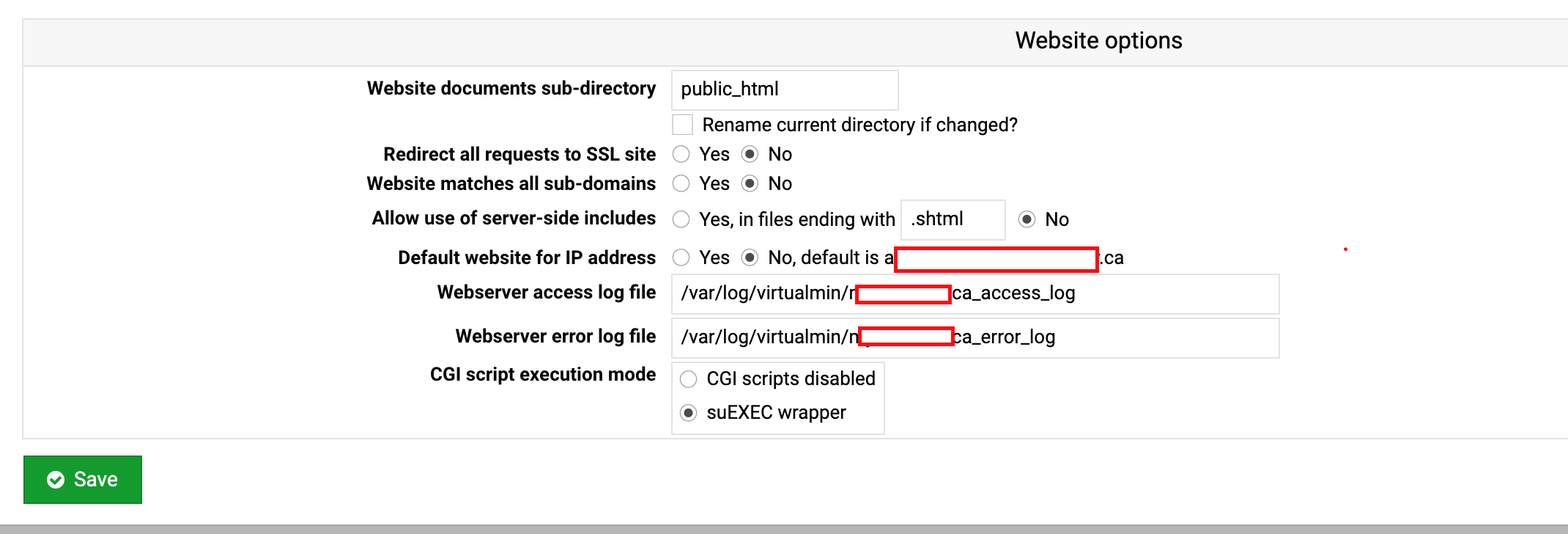

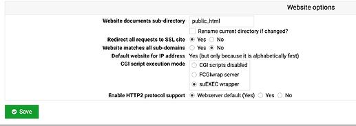

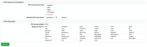

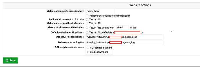

@Joe Thanks for the reply. I’ve provided a screenshot of the php options in virtualmin below.
So how do I check if mod_php is installed? I guess I should have showed php modules, sorry. I just do not think mod php is installed. But then again, have trouble trying to enable and disable using a2dismod/a2enconf because it does not find my

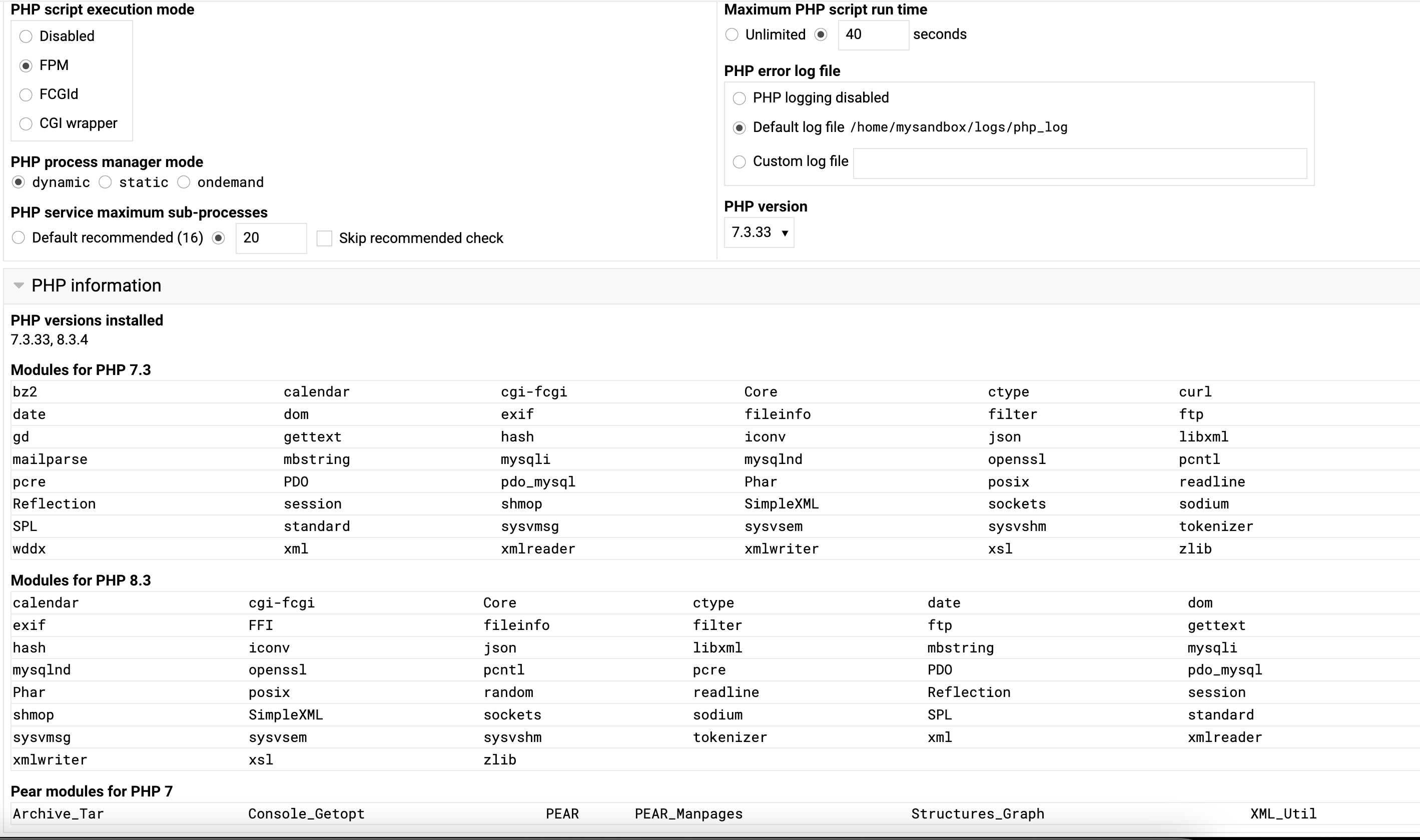

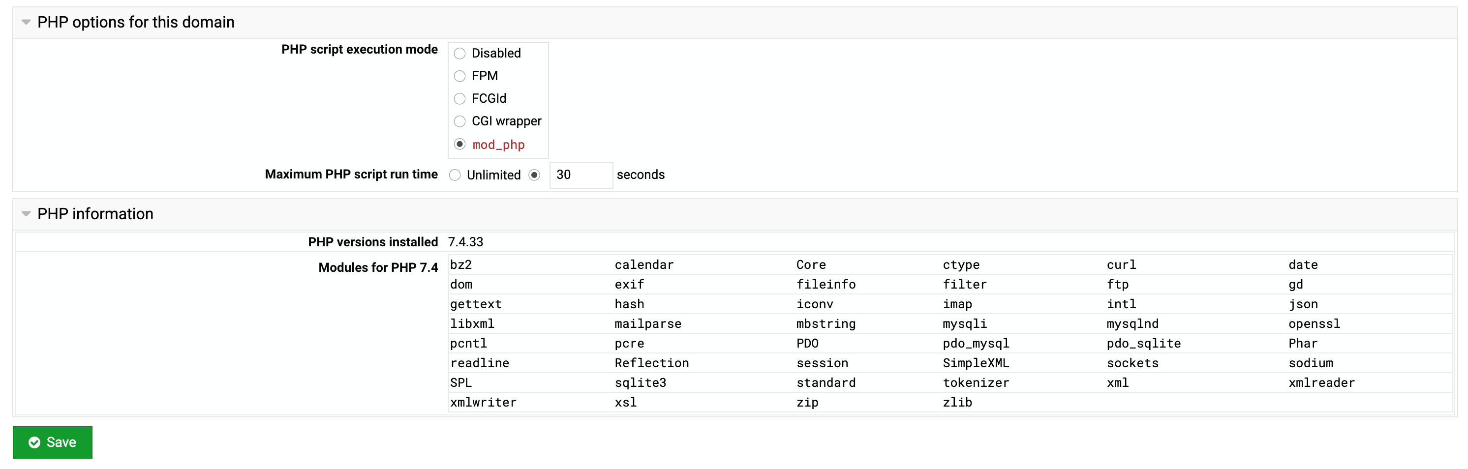

I’m very confused with this since I have 3 virtualmin’s running and cannot understand really how this is working to have php run as the domain user.
This is a working server running as domain user config: CentOS7
This is a production server running as a domain user config: debian 11
The server not working has screenshots from my previous reply. I’ve tried matching configurations etc and just cannot get it working as domain user.
If anyone has any experience or things to look at troubleshooting why this would happen please share.

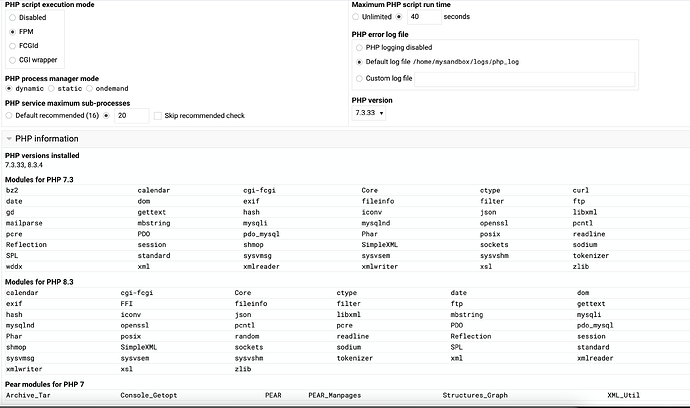

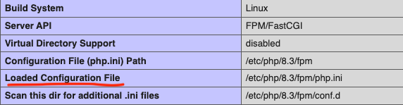

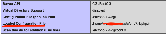

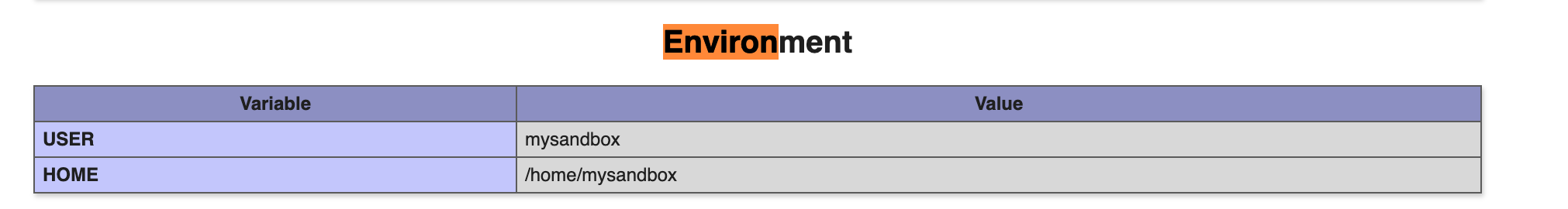

The one thing I found different in phpinfo() was that this path compared to my working virtualmins. I do not know if this has any relevance.
This is working
Screen Shot 2024-04-03 at 11.32.13 AM
This is my problem machine
Screen Shot 2024-04-03 at 11.29.57 AM
FPM and fcgid would look quite different. But, when I look at my systems, they do report the right user (but I’m not looking at the Apache process, because the Apache process always runs as the Apache user, and it’s not expected to do otherwise).
(This system is running with FPM, of course.)

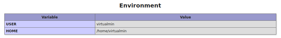

Wait. In this screenshot, Virtualmin on debian 10 cannot get apache2 php to run as domain user - #9 by gstlouis
The domain name is being shown! What makes you think your PHP apps are not running as the user!?

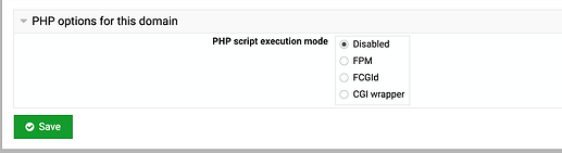

@Joe
I believe this for sure, because when creating a dummy domain proved the virtualmin script is working I think.
sorry, this is from the dummy domain I created, showing us that creating a new virtual server on this is machine is working just fine.
So I just need to try and find out where I went wrong with this problematic domain so maybe I could share. If not, well I’ll just have to re-create it. Unfortunately, its been so long this machine was made I do not recall if I did things outside the virtualmin way. I do know that my apache2 .conf file for this problematic domain is titled with 0-domain.ca.conf when usually domains start simply with domain.ca.conf, so its like it was deleted and rebuilt or something. I just don’t remember.

I actually have this error in php options
