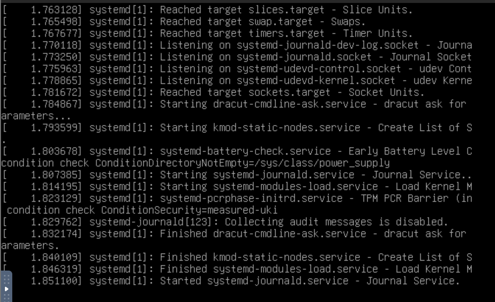

I have the same problem, not on ionos - fresh 26.04.01 on binarylane (checked re-booted OK first), then fresh virtualmin install (lemp, mini, no mariadb, postgres) - then log in OK to virtualmin, do wizard to say start postgres and not mariadb, do the recheck configuration thing, and then see Warning reboot required, so I do that, but boot stalls with similar screen as OP:
I manually applied this suggested fix onto a fresh 26.04.01 install, then installed fresh virtualmin, and now it reboots OK: fix(net): avoid boot deadlock when starting systemd-networkd-wait-online by AryanHamedani · Pull Request #7053 · canonical/cloud-init · GitHub
