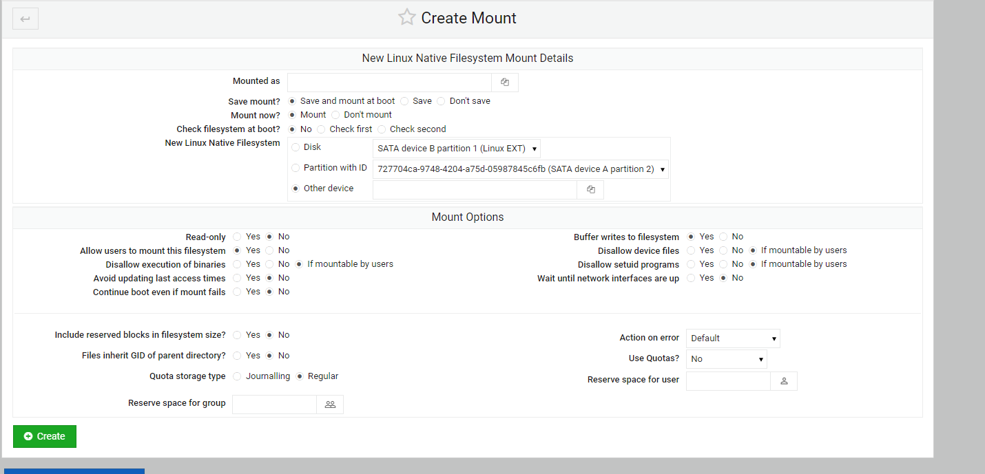

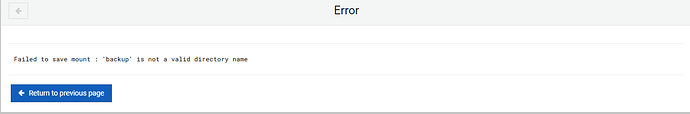

when name it this box shows up
I think you need to make the directories first. Use the /mnt location and see what happens. You need the forward slash.
is this what u mean
pick a location, like i said /mnt is free. So either type it in or use button to the right to pick the location. the location needs to be empty. all else should be default
right ok i understand

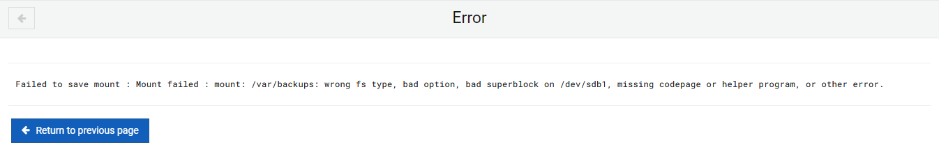

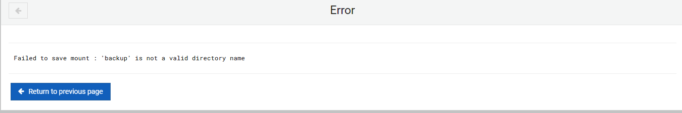

now this is showing up

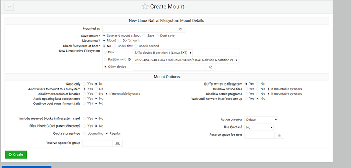

from
can you just add /var/backups, plus you have created that directory?
Also Create a ext4 filesystem first.

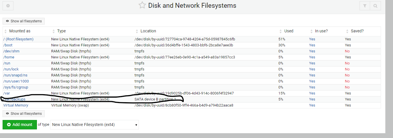

its just creating the ext4 filesystem now
its now mounted the filesystem as it says in the box i marked

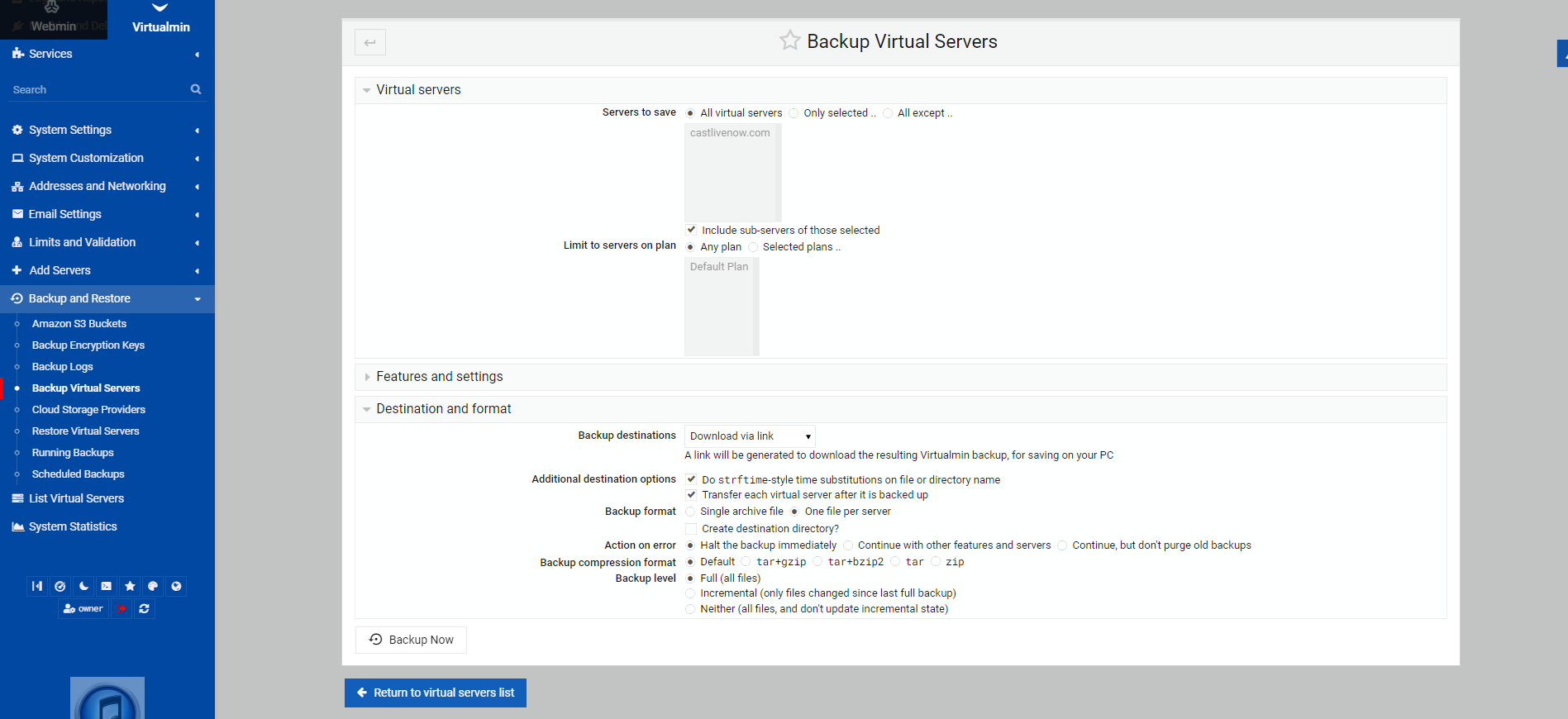

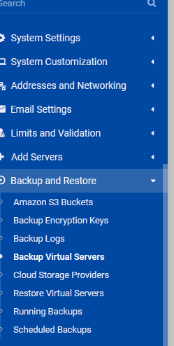

but when i go to backup the system to the mounting point i just made its not letting me click backup now
you using backup servers?

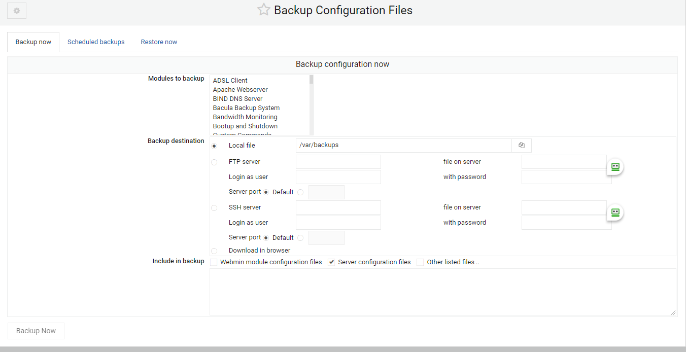

is this what you mean
Yep and select backup destination as local file or directory.

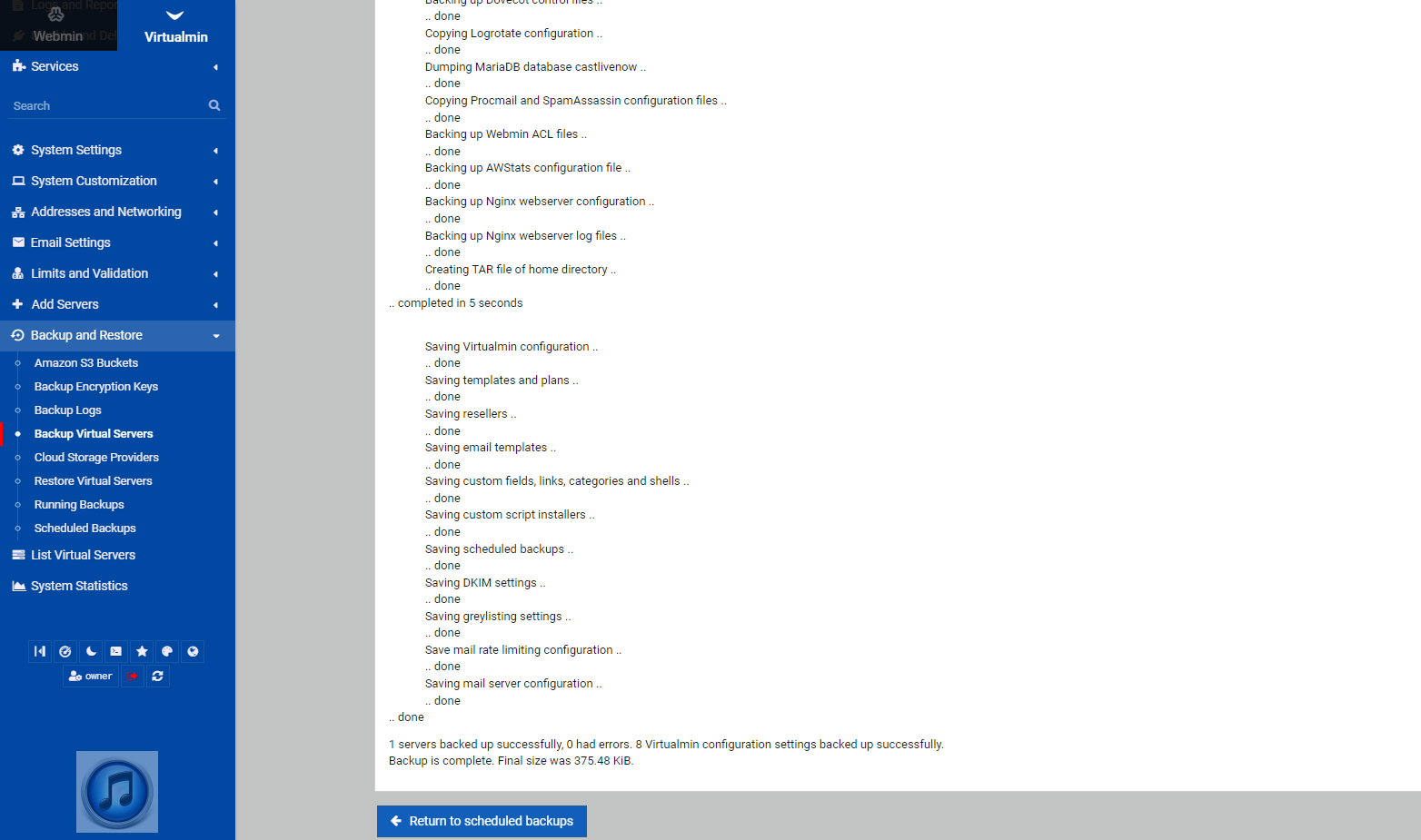

yes i have done that and its done now thank you so much for your help today

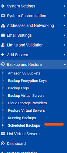

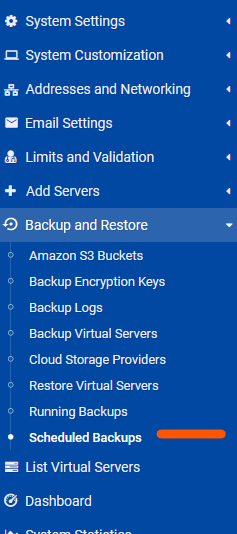

you can setup scheduled backups too.
yes i have just done that too
