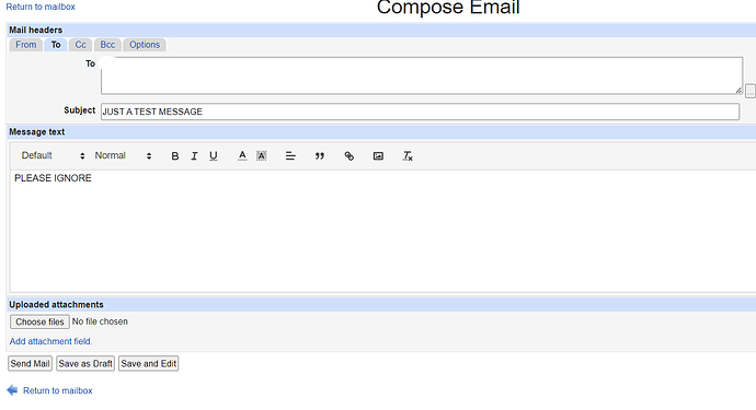

But it doesn’t. Just as I indicated above (with the normal theme) It adds the “draft” as an attachment - revealed by those . . .. Then I could probably add an additional message (perhaps) and send it. But the user’s message should have gone out without me tampering with it.
No spinning button just
so that points the finger at the Authentic theme (I guess) at least for being stuck with the spinning button of doom.
Still think the “Edit as new” is not doing what it claims to be. It is not allowing full editing of draft or even what is actually needed “sending of draft”
@Ilia did something change in the mail editing UI in the most recent release that would have impacted how editing a message works? I don’t think we need that separate reply section for example…

Yeah, I broke it when adding a new replies functionality. Here is the patch:
Sadly, there is no easy way to combine new reply formatting and draft messages…

So is that the reason it is stuck in “Draft”
or
is that the reason why “Edit as New” includes the message under the . . . and acts like a completely new message" still leaving the message stuck in “Draft”
It’s the reason why Edit as New was edited as a reply.

Tx @Ilia for fast response. So if I implement the code change in that link. the “Edit as New” will be back to “Editing the Draft” and the “Send button” back to “Send” and in theory it should go out as normal - just like my test messages did?
or should I wait for an update.
I just provided a fix for the draft not being editable.
If there is another bug, you should open a new thread, I think.
OK, that is a solution to question raised by @Jamie above not my OP, which is about the message that never got out of Daft and is still stuck there.
There was a suggestion to “Edit as New” that was indicated might resolve it - but as I said above an inappropriate title on the button when all that is wanted is “Send the draft”
