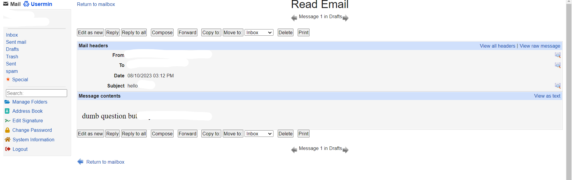

PS. just gone in as user and tried sending a test email to myself. Everything ok up to clicking on “send” (no attempt to schedule) it has also gone to draft (very quickly) and then remained stuck on page with the “Send” button “not allowed”
No. Is that what it means?
Ill try and see if that sends it out.
Not what I expected! That shows the original mail as a included/attached message with the space open for a new message (as if it is a forward) not only that it gets stuck in swirling circle of doom mode when I try to send.

I didn’t. But I believe that is what was checked by the usermin user for the first message that got stuck in draft (and still is)
However. That “please ignore this is a test” message that I did without scheduling did eventually get out of draft and that stuck spinning “send” button did eventually go - or at least give up. It has not appeared in the Sent folders. But it has probably disappeared due to logging in to usermin afresh today and browser refresh.

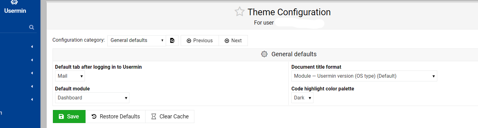

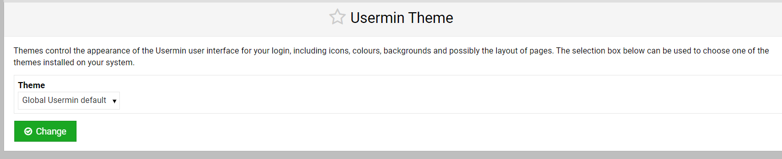

How? Don’t see that option. I assume that will only affect me signed in as that particular user on that VS and not cause suprises to othe VS and users on this box?
You need to go to Webmin ⇾ Usermin Configuration: Available Modules first to enable Change Theme module and later change the theme from within Usermin using Usermin ⇾ Change Theme page.
I would go with edit as new message, this is the way you would do it in thunderbird, as a side note I sent a test message on a schedule it worked perfectly and at the exact time maybe you have other issues
