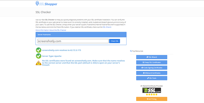

and when i checked my domain with:
ssl checker website
i get this result
No SSL certificates were found on www.screenshotly.com. Make sure that the name resolves to the correct server and that the SSL port (default is 443) is open on your server's firewall.
and iam sure that before i rebooting my webmin the result was that my domain has a certificate installed.

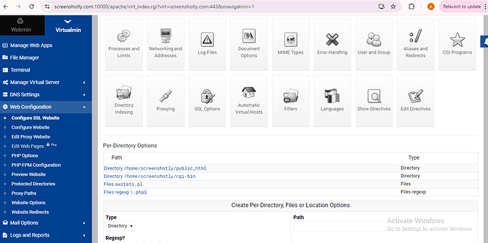

and i want to say also that when i connect to my webmin through mydomain:10000
it shows that the certifcate is working

i checked my website link with ssl checker website:
[type or paste code here](https://www.sslshopper.com/ssl-checker.html#hostname=www.screenshotly.com)
and he show me that i dont have ssl certificate But
iam sure that iam installed it successfully with let’s encrypt

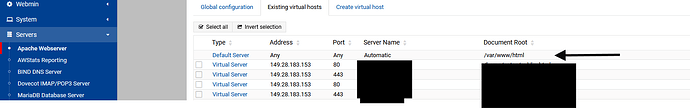

is the virtual server showing ok here

i checked my link with ssl checker and as u see it told me that there are no ssl installed but before the issue i was checking it everyday it was working well and show me the certificate
the ssl issue is a because the virtual server apache config has stopped working is what I’m seeing. That why you see no error log after the restart.
and i run let’s encrypt code to check my ssl status and i get this :
but i checked apache server and i found it running
Yeah its running but the virtual servers directives are not being followed, it has screwed up some how and not sure how as I’ve never seen this before.
this sort of proves it, I thing its following the global location. and loading this location
