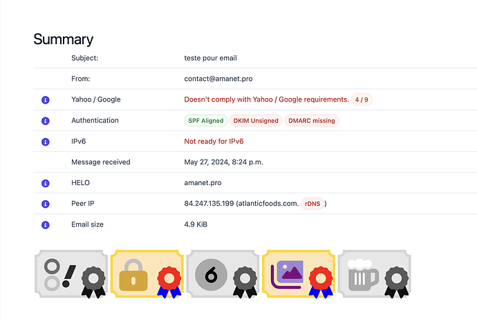

SPF Aligned DKIM Unsigned DMARC missing
please I have problems with emails and sport on all with google it goes directly to spam please how to do that

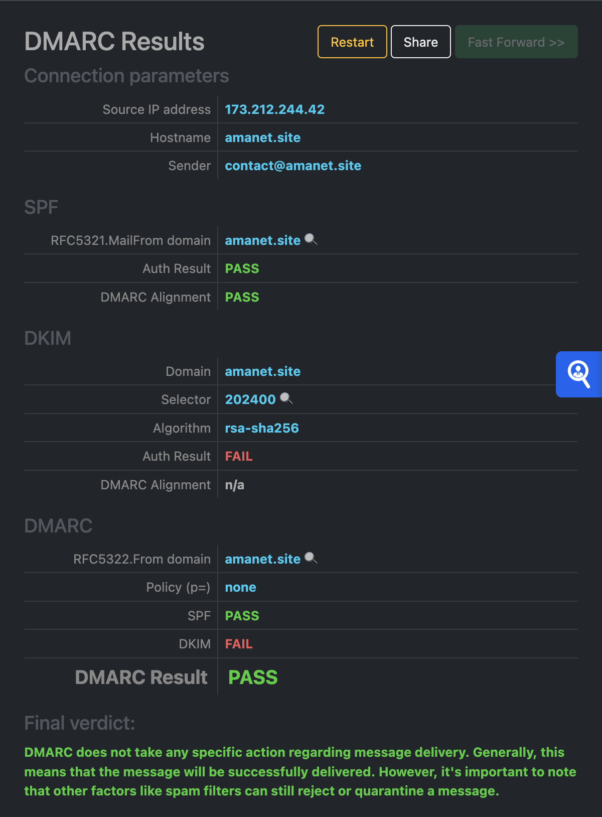

NOTE: google will still sends thing to spam even if both work, it maybe content that’s sending it to spam. Google has a system like spamassassin that rates content.
But Dmarc and DKIM look to be off.

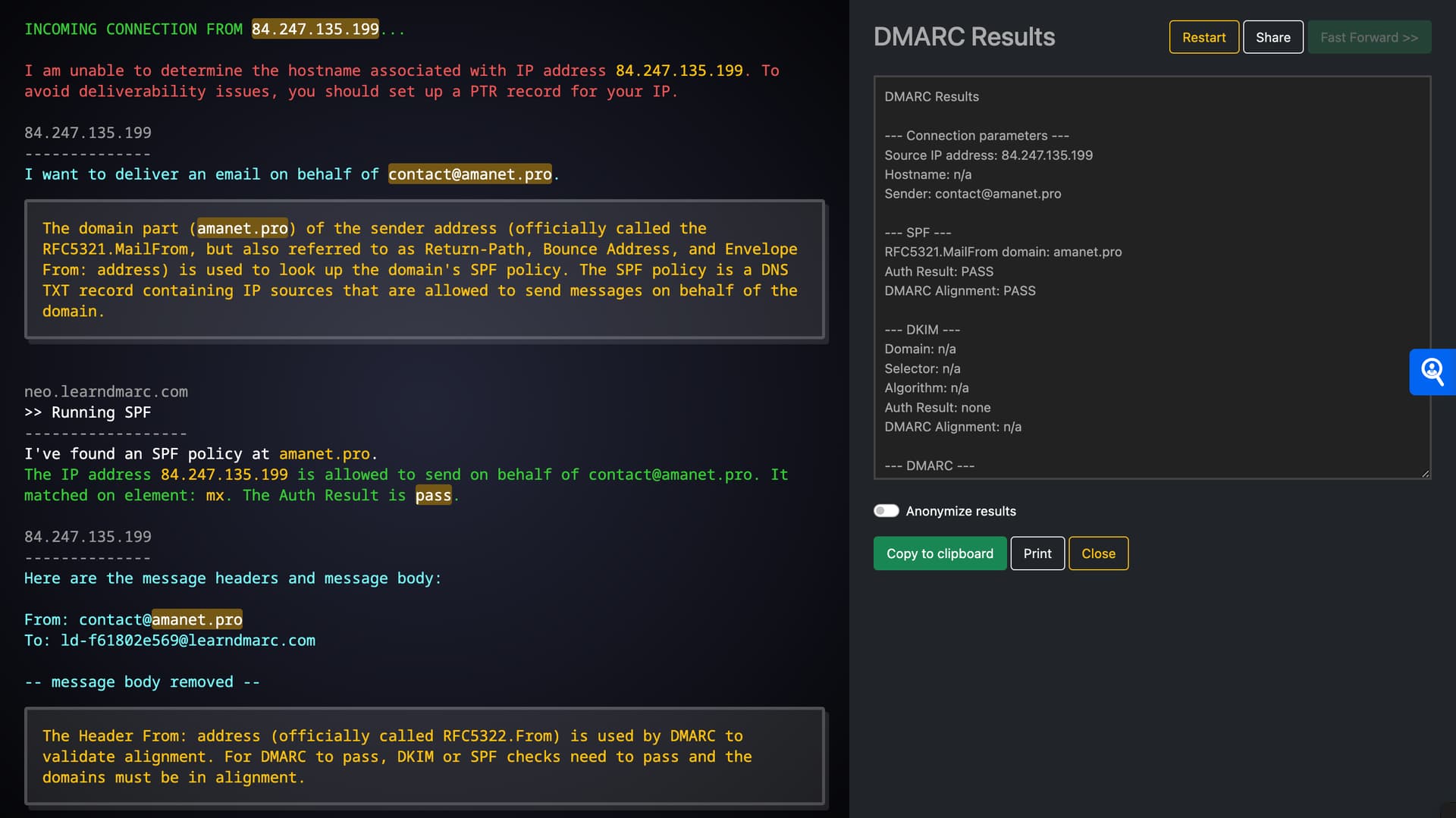

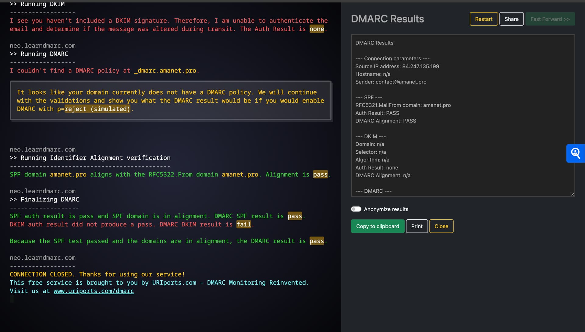

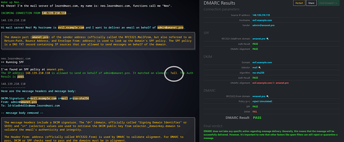

this service will breakdown your issues
I spoofed a email address using the service and it allow anyone to send from you domain, that need to be tighten else spammer can use your email address

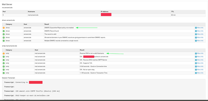

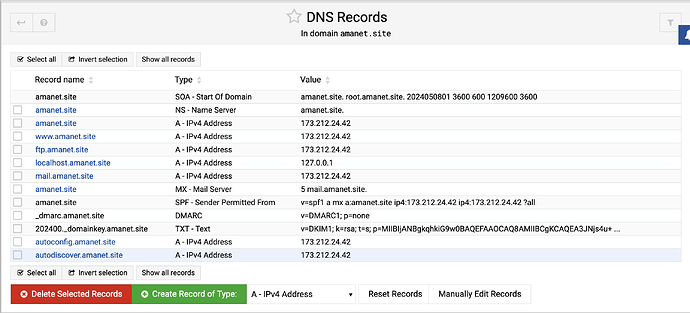

you may want to fix what is noted by the green arrows

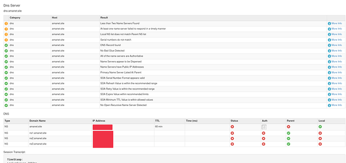

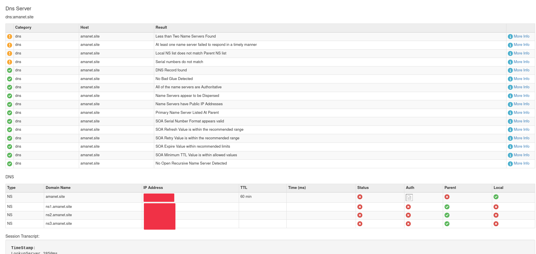

your dns is also a mess

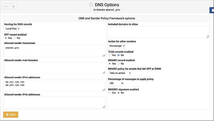

Do you mean servers or virtual servers one same server. I know the record are correct so I set to reject, you may want quarantine.

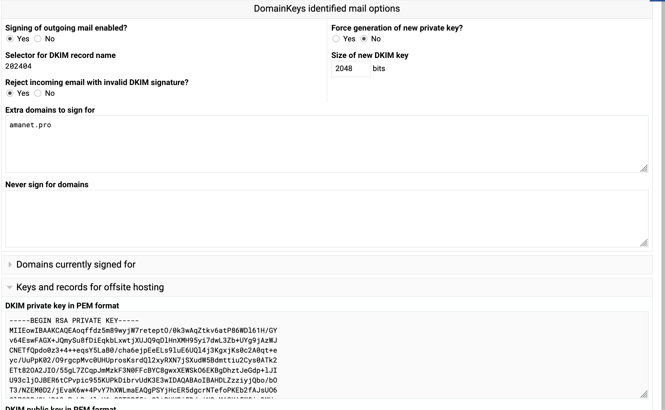

You need to add each virtual server domain to the signing, you only have one there.
also check the dns option on the virtual servers
Do you host DNS locally and is it controlled by Virtualmin? If not, you’ll need to manually add the mentioned records in DNS Settings ⇾ DNS DKIM Record to your DNS.

If you look further up the thread there are references to amanet.site just wondering if the OP has used .site as a mail server to negate the limitations of cloud flare and therefore perhaps everything is not configured correctly an the webmin/virtualmin instance
