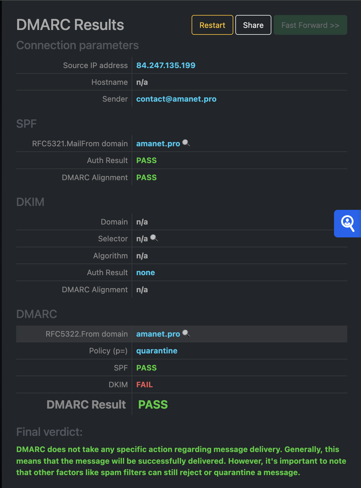

SPF Aligned DKIM Unsigned DMARC missing
Thats par for the course then

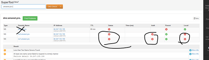

What about nameservers for amanet.pro domain?
is it good like that
It doesn’t seem good to me, e.g.:

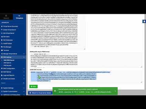

Please cheak the video it is my instalation

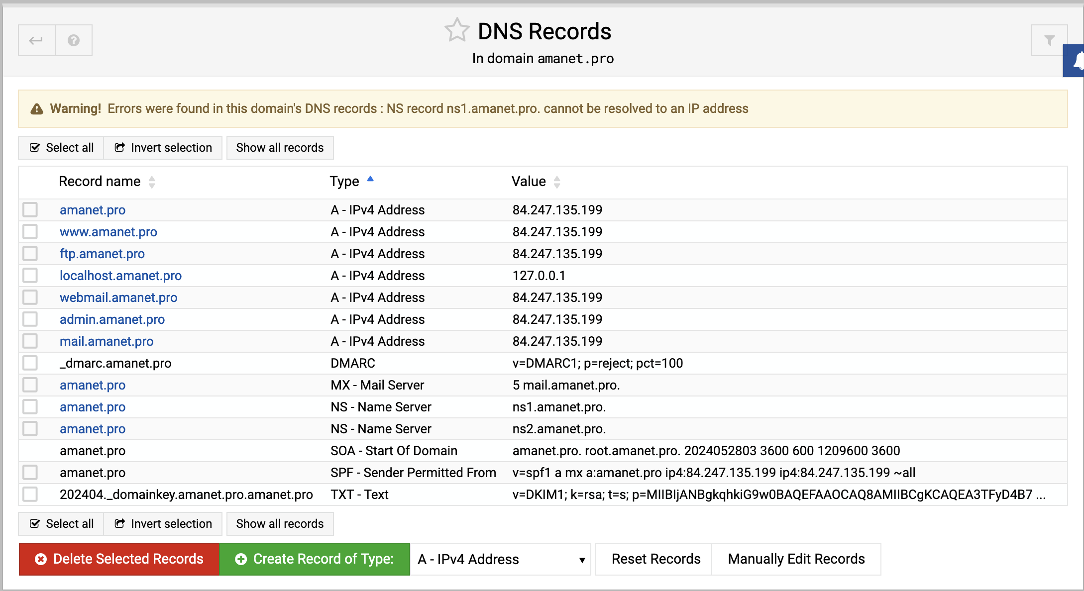

Look at the screen shots I posted earlier you neex to fix both the dns errors and the mail server errors on the .site server. If you are going to host your own dns it would be a good idea to point the secondary dns server to the .pro server and use the webmin cluster option to manage them. Your mail server issues can be addressed, perhaps, after you have valid dns for both servers

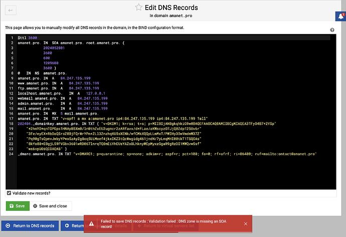

You need 2 name servers you can continue to host your own but at least they should not be on the same ip address and perhaps not on the same sub net. If you can not or do not want to do that revert to your suppliers nameservers disable dns in virtualmin and copy your dns records to their interface, while your there change the rdns to a valid one
And you need a dot here
Between domainkey and amanet

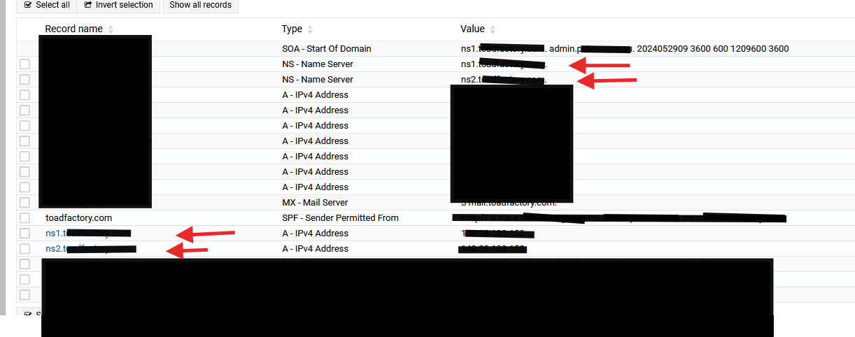

create A records for ns1 and ns2, remove root domain as a NS and the SOA, and use ns1 and ns2 as NS and NS1 as the SOA
At registrar remove amanet.pro as a nameserver.

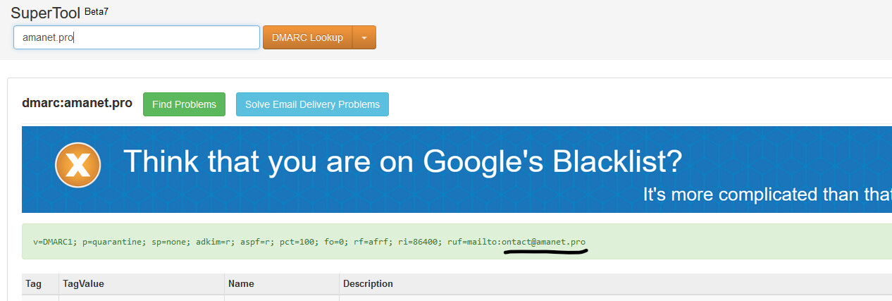

dmarc good (now) now except for the contact address, is that a valid email?
I would add a report rua=contact@amanet.pro untill you get it sorted

when I want to delete SOA the system doesn’t let me do it

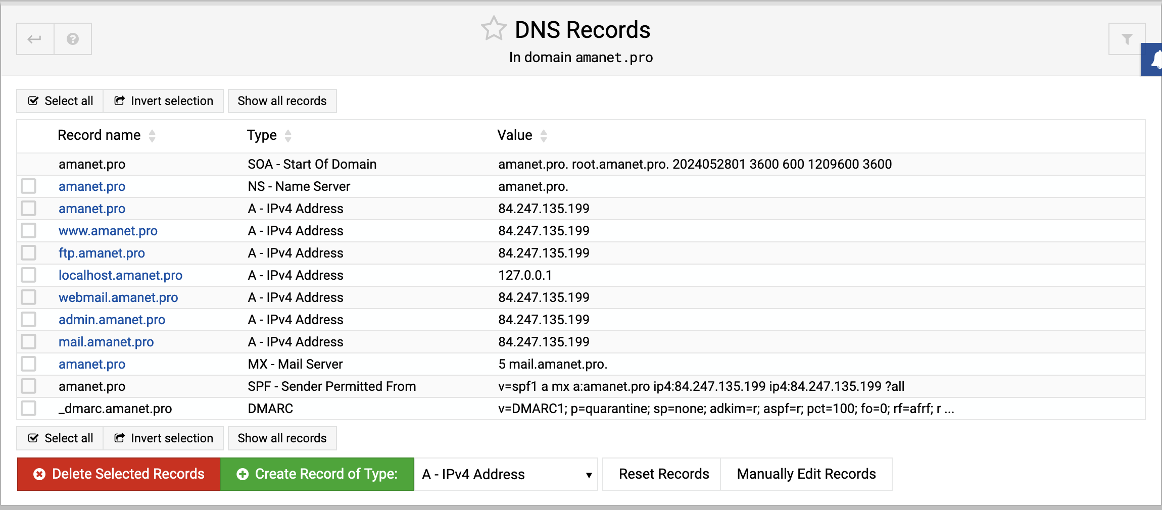

my brother here is the text please correct it for me and I will put it where the first

You need to add 2 extra NS record N1 and NS2 and A record for them to match registrar

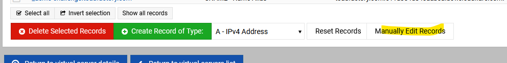

You can manually edit as well
