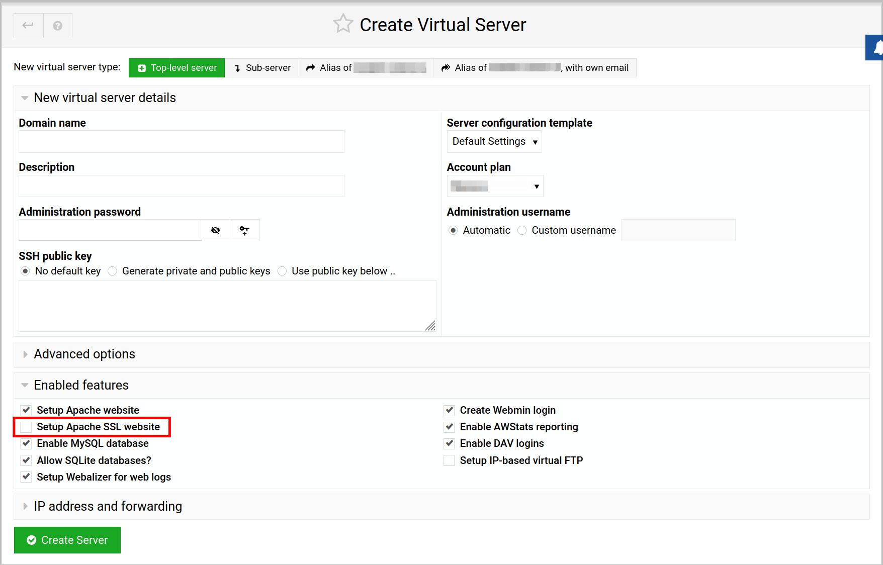

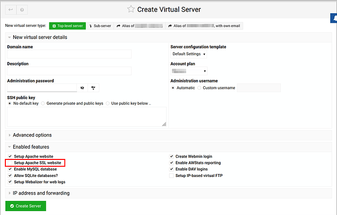

Flames aside, the latest Virtualmin version - 7.40.1.gpl - has no visible means to go with HTTP by default. Really, I checked with other server I installed at last week, but with Ubuntu Server 24.04.3 LTS. The same problem repeats. You see, the older Virtualmin versions had the possibility to skip SSL on default during virtual server creation. Particularly Virtualmin 7.10.0 that I have in other server.

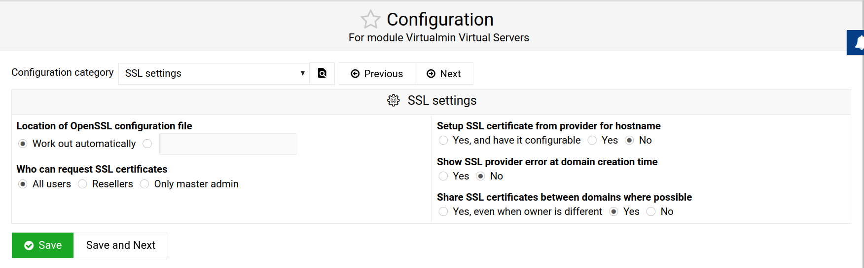

SSL settings in Virtualmin configuration there has Let’s Encrypt entries you marked in your post.

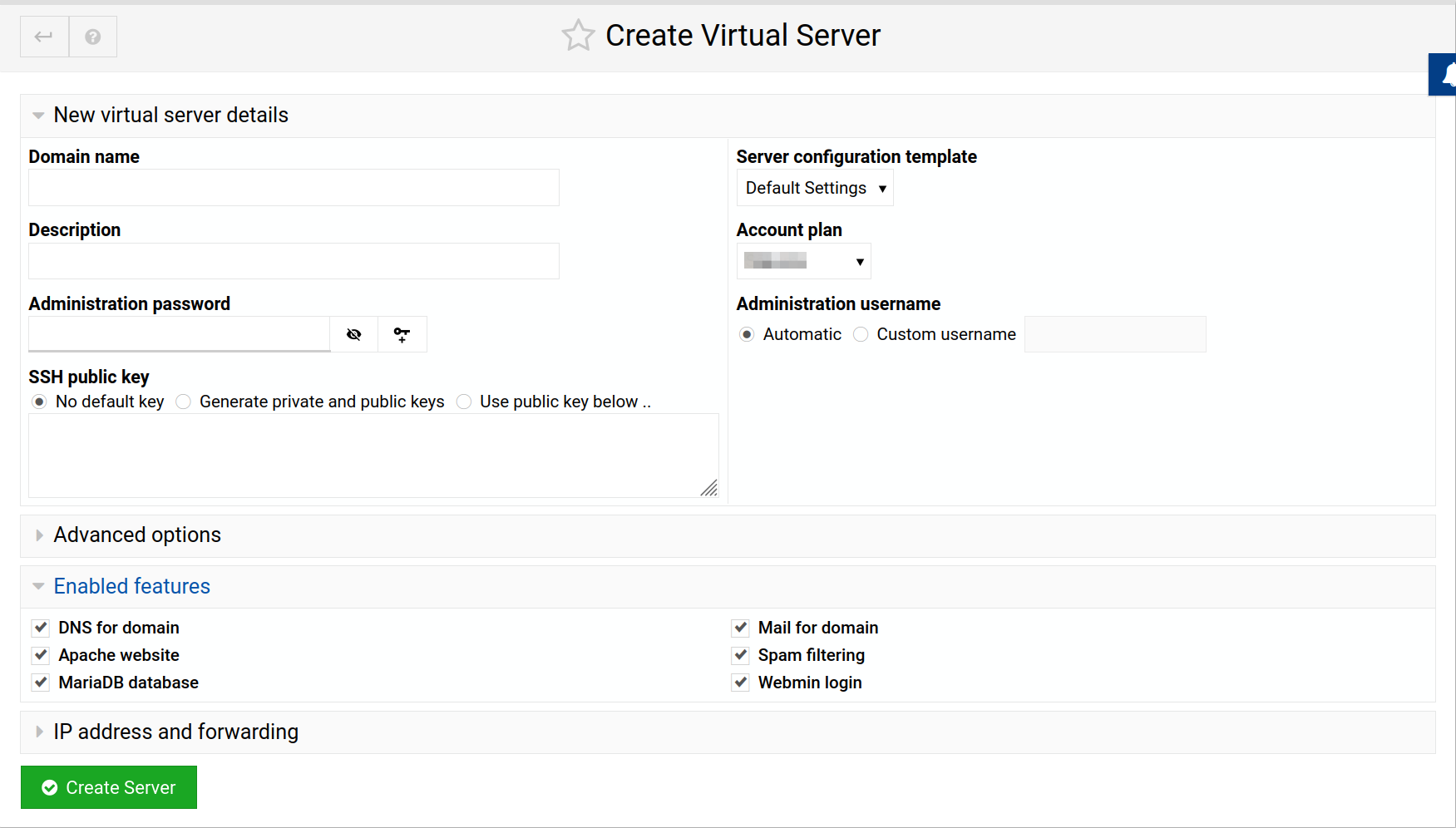

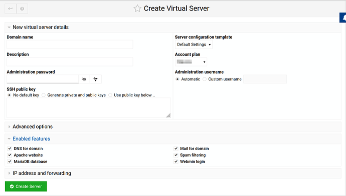

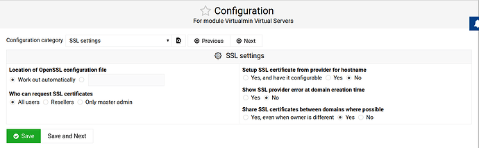

However latest Virtualmin version - 7.40.1.gpl - lack the possibility to skip SSL on virtual server creating. The same Create Virtual Server form in it:

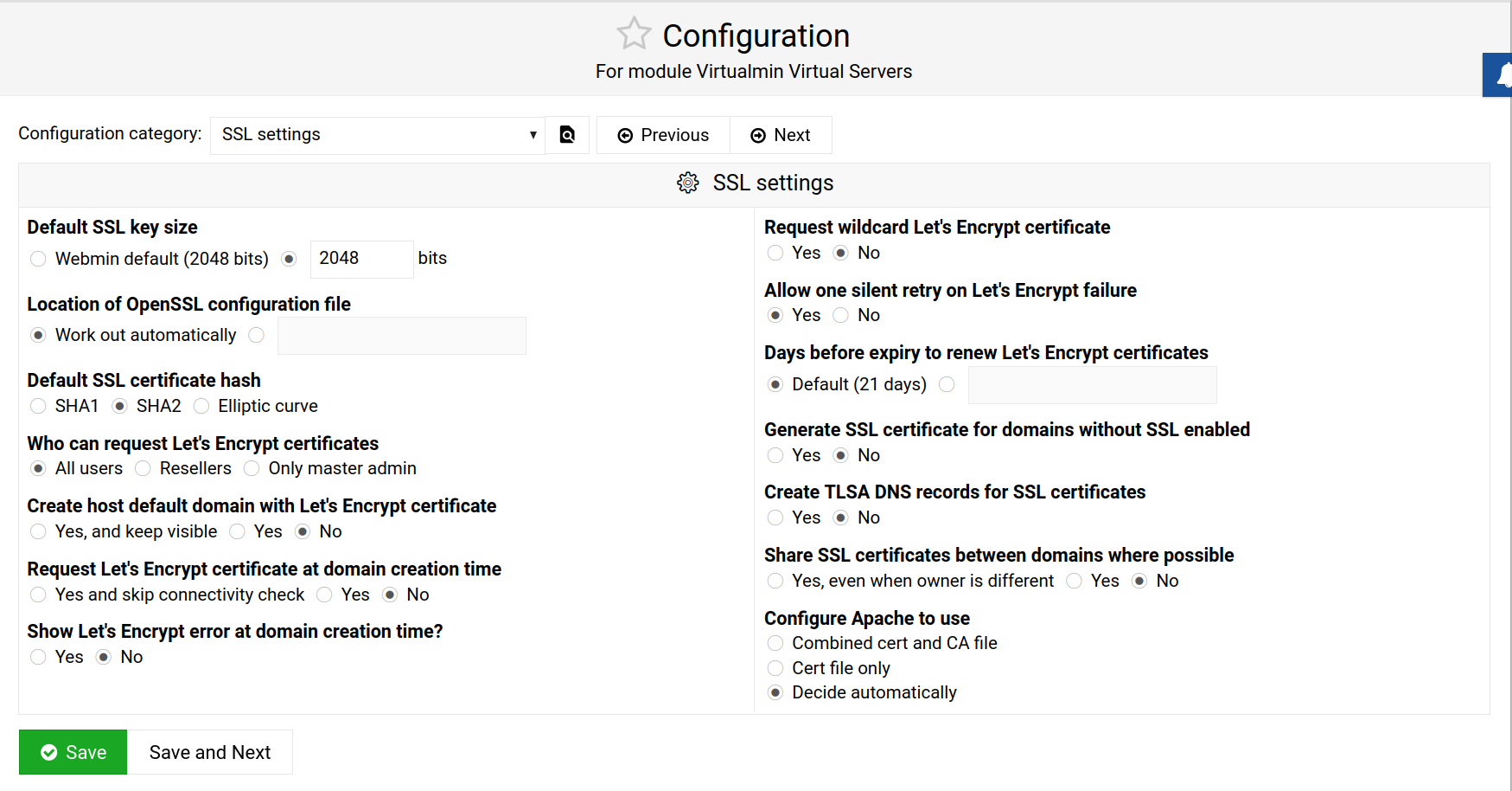

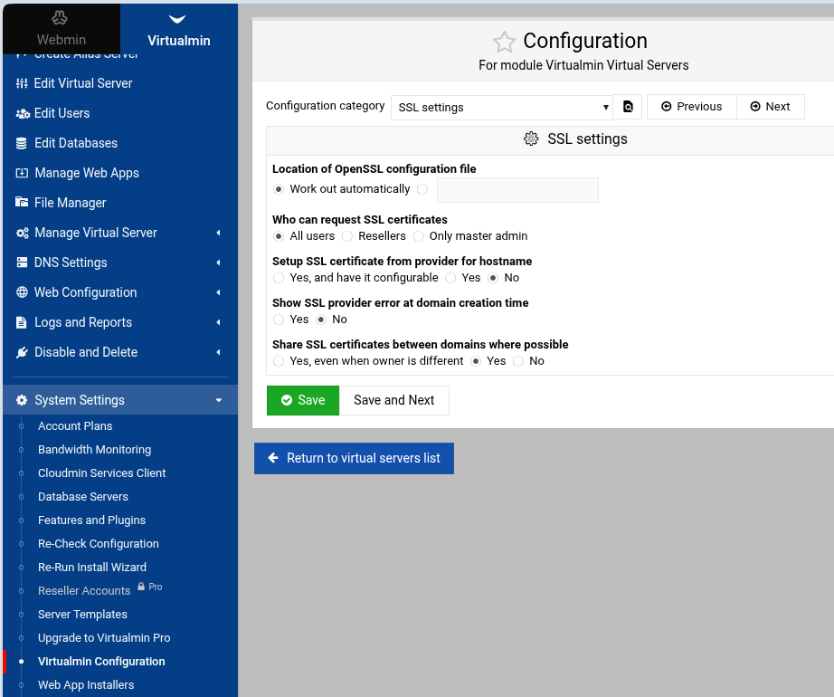

And SSL settings in Virtualmin configuration:
As you see there is no way to choose or refuse SSL on virtual server creating. Without it Virtualmin tries to create SSL certificate on each new virtual server creation and freeze for like 5 minutes with that till Lets Encrypt kick it out with “Too many failed authorizations recently.”. I have no idea where the SSL website checkbox or whatever control it uses now is hidden. IMHO it is either moved under some unrelated name or removed from miniserv completely because I found nothing in Virtualmin settings what might work for disabling SSL by default for virtual servers. Maybe you know where I can do it in latest Virtualmin - I am out of ideas.

The biggest ‘problem’ with the software is number of choices it gives you and they may not be the easiest thing to find. I believe this is where you disable automatic though.
My Virtualmin configuration “SSL settings” form look exactly like yours. But on each new virtual server creating Lets Encrypt certificate enrolling is fired despite what is set here. I started to investigate… In never Virtualmin versions SSL certificate provider configuration is moved behind paywall. Suspiciously look like that now the SSL website feature in Virtualmin is enabled by default and can’t be disabled in community version. As I said earlier, poking around other SSL options didn’t helped. But… there is still Virtualmin CLI API where is possible to create a new server with create-domain command (it is a Perl script actually) from a terminal. The description page for create-domain command in Virtualmin online documentation has the sentence

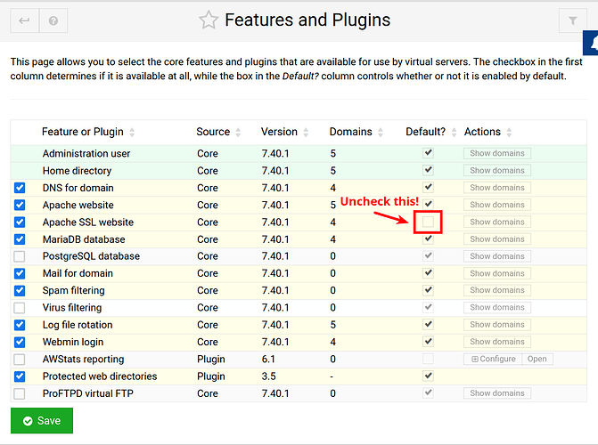

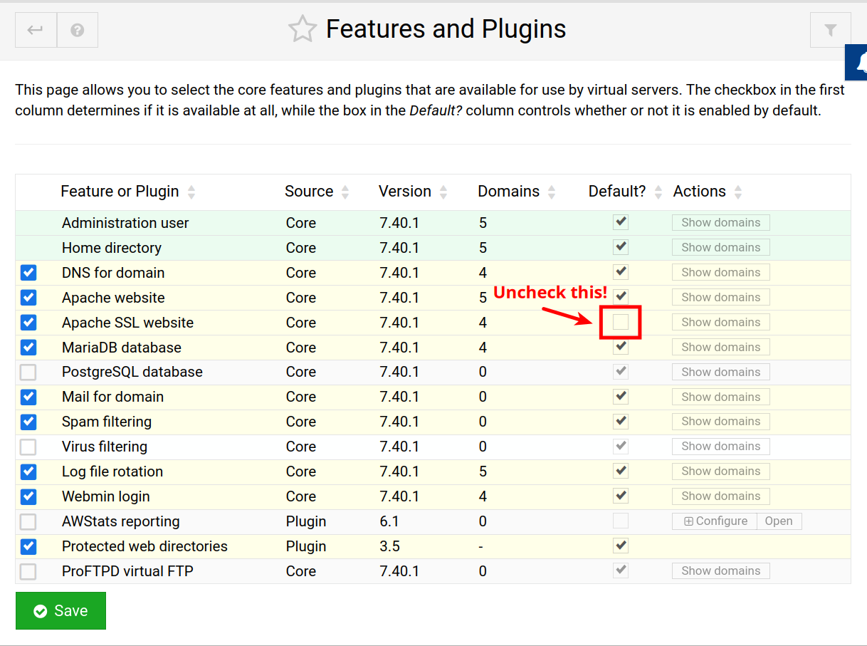

Go to the “System Settings ⇾ Features and Plugins” page, find the “Apache SSL website” row, and disable “Default?” for it—then the option will be visible in the UI.
This feature is chained by default with non-SSL websites, which is why it is hidden by default.
You can disable this on the “System Settings ⇾ Server Templates: Edit Server Template / SSL website for domain” page by using the “Request SSL certificate from provider at domain creation time” option.
We have no “idea fix”—we did this to simplify the UI. :slight_smile:
Virtualmin code is complex. Please don’t edit the source code manually, even if you can—just ask us; we’d be happy to help or add anything that’s truly missing.
Indeed it works. Where you been before? :smiley: Definitely you should update Virtualmin documentation better about this or pin this thread. I noticed arbitrary number of other people who searched for solution for this exactly problem. For you, guys, there is how it look in my Virtualmin settings:
