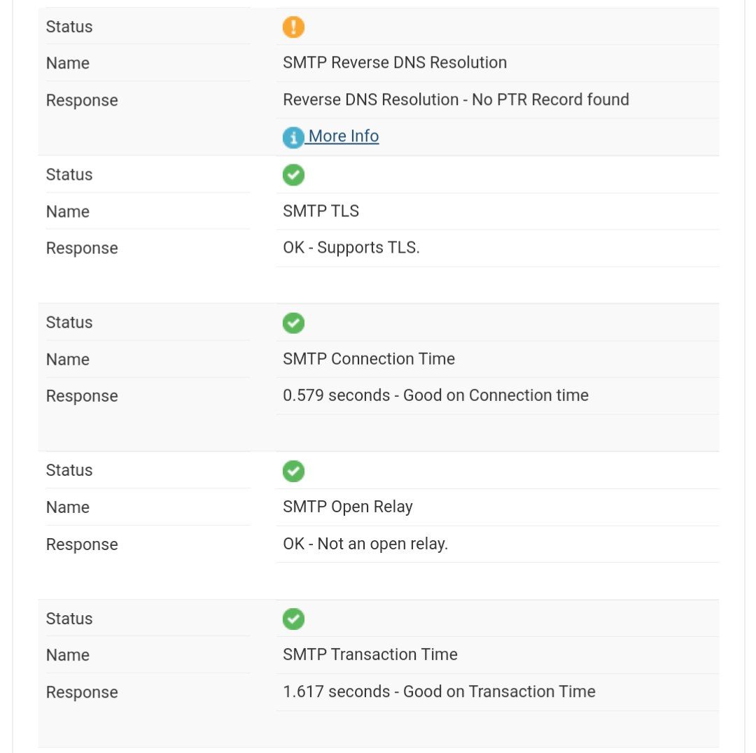

Check open ports and smtp service with these.

Yes, it is blocked, I saw the sending error 25
I think this problem can be solved with proxy or Tor, I tested with terminal, port 25 465 587
