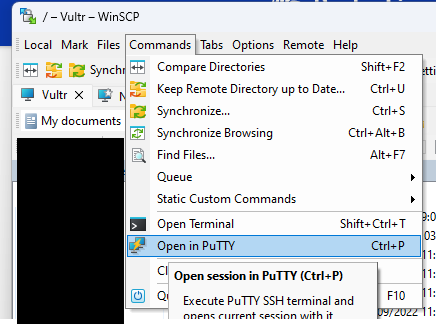

This may be the problem. I’m using WinSCP because the internal terminal is confusing the typed characters. https:// > https??
I just installed, interesting it imported my putty settings and certicates and looks like filezilla, nice.
you can use open in putty to run script
Yes, a good idea. I’ll give it a try.
Thanks for your suggestion. The installation went perfectly.
