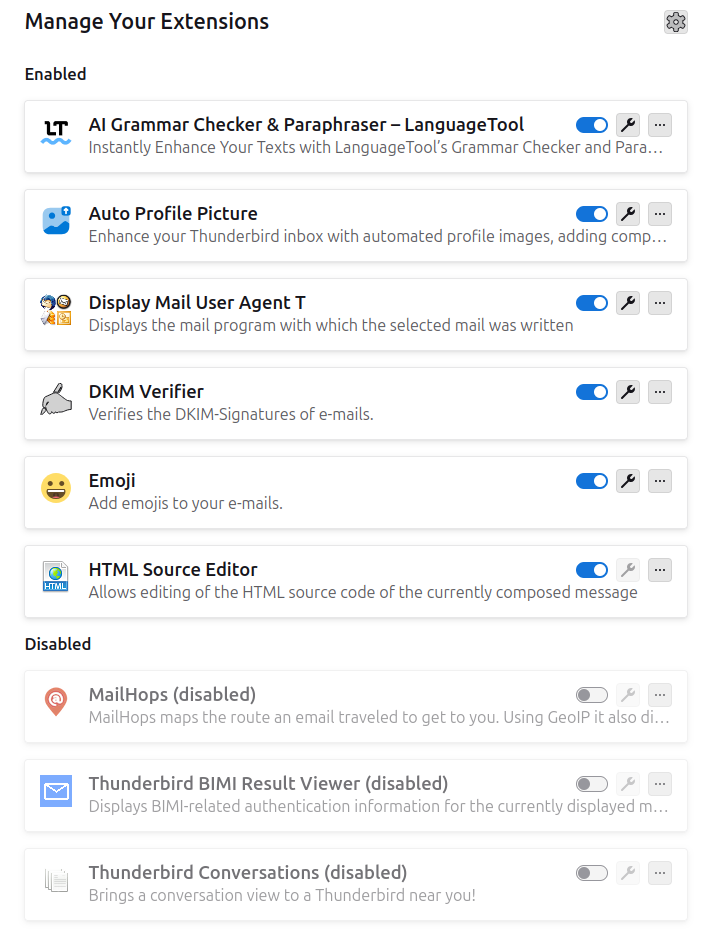

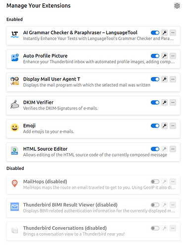

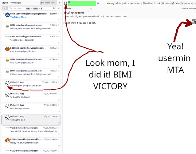

Bear in mind that it appears most freemail companies’ web interfaces and installed mail clients have no facility to display the BIMI. I have proof of concept through a Thunderbird plugin.

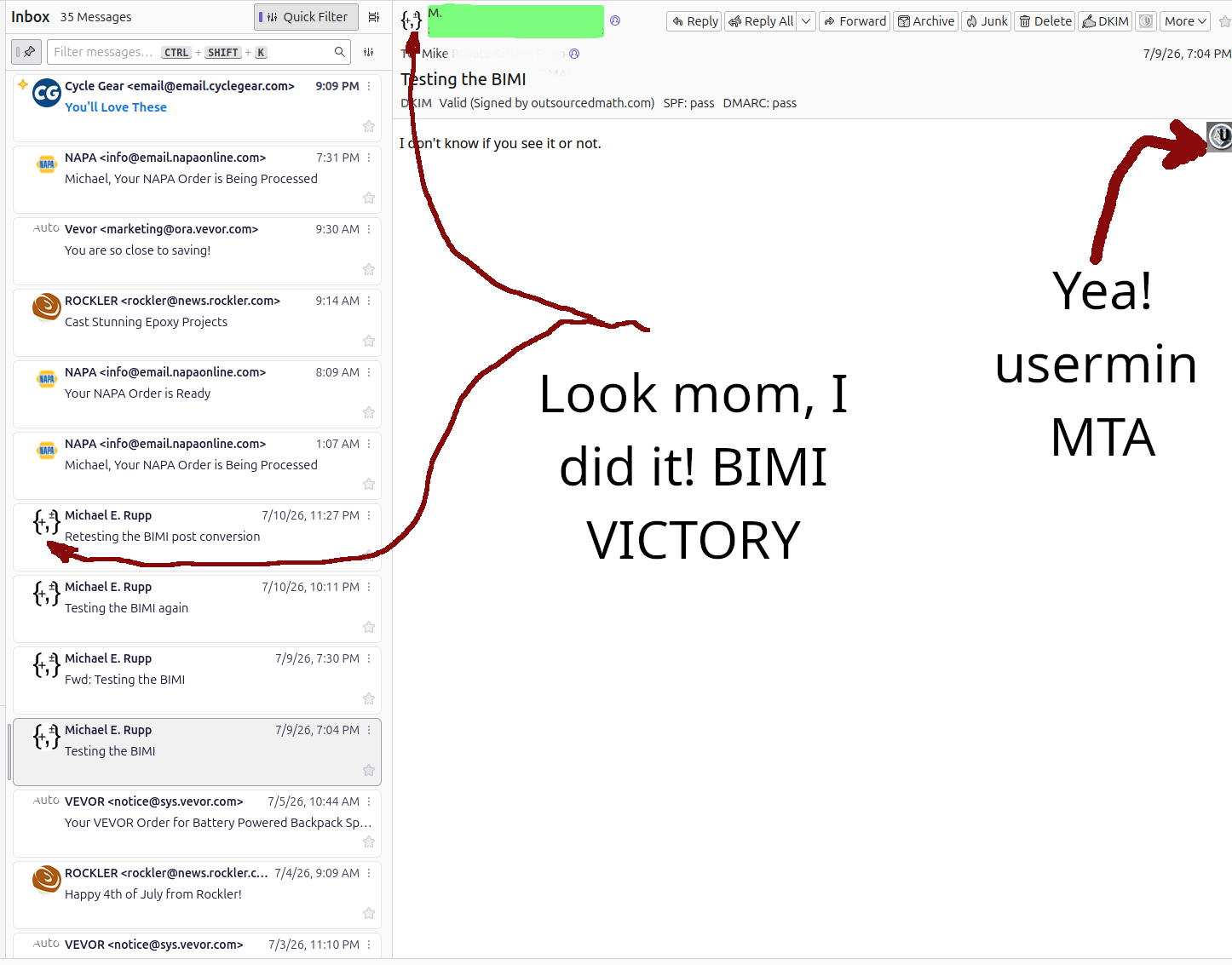

The view from my old Yahoo! Mail; a lightning rod for spam.
So I sent tests over a couple of days, and once I got things right, all the old failed test messages had the image appear.

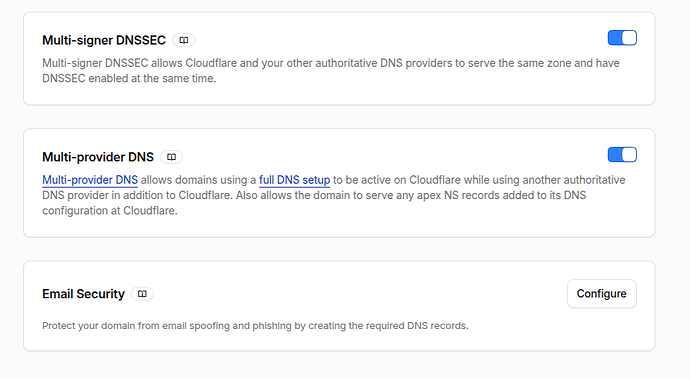

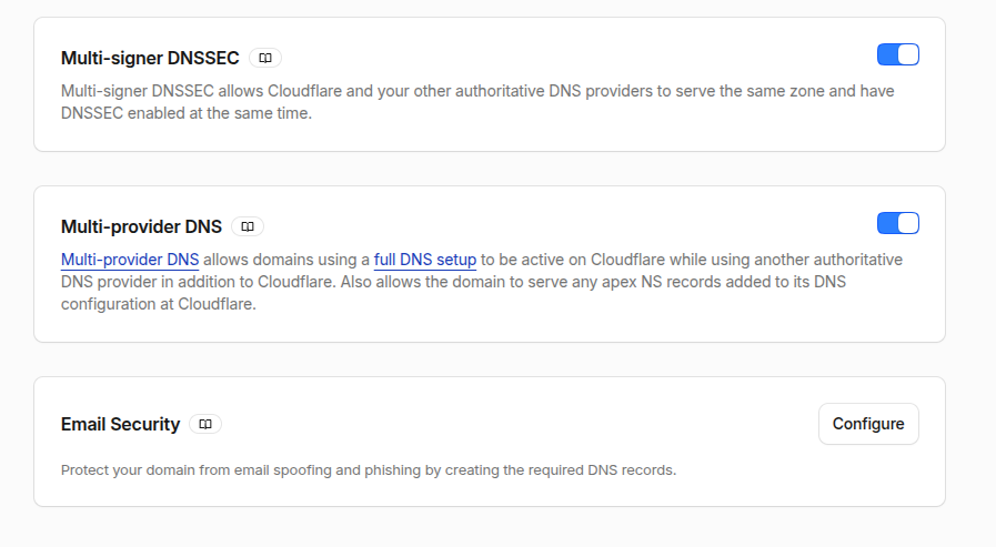

Because I struggled to migrate this second top-level virtual server and its sub-servers, where the eMails didn’t seem to work as expected, I was led to Cloudflare and its settings to help get things working. Mail seems to be working pretty well right now, but last night I got my own second-class-citizen BIMI graphic to work at the cost of $0.00 USD. (I’m still worried that free means I’m the product.

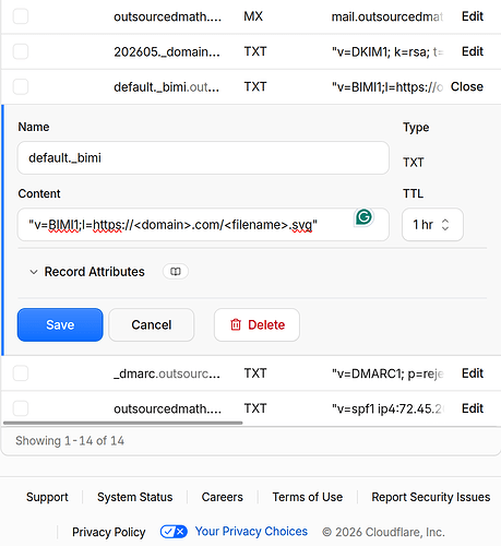

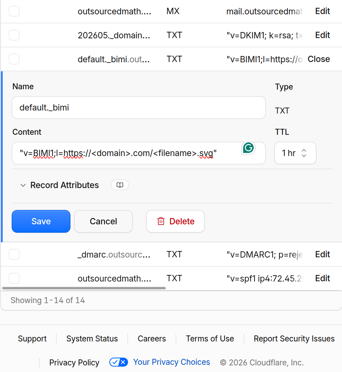

The Cloudflare portion was pretty much just copying & pasting records from Virtualmin DNS, but the BIMI was one extra record.
I did also put a copy of that BIMI DNS record in that Virtualmin’s virtual server’s DNS records. I’m not sure if Cloudflare tells people’s mail clients where to get it from, or if Webmin is doing it via BIND.

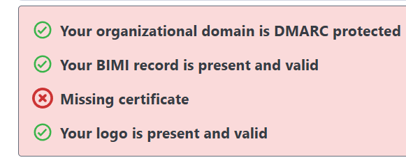

I went to this website and uploaded my SVG: https://verifybimi.com/
It’s a really simple converter where people should insert a fake logo they won’t use to get the output and reverse engineer what it did. They give you two outputs after you upload a graphic; a modified SVG, and a TXT output of the vector instructions to make that graphic.
So if my privately created non-PEM image is supposed to be a way of showing my authenticity with eMail, why did I hand that image to a stranger who made the version I will host on my Virtualmin server? Their website could have a copy of my production BIMI file to sell off if I started doing something successful, or use it to spoof my mail identity for malicious ideological reasons.
