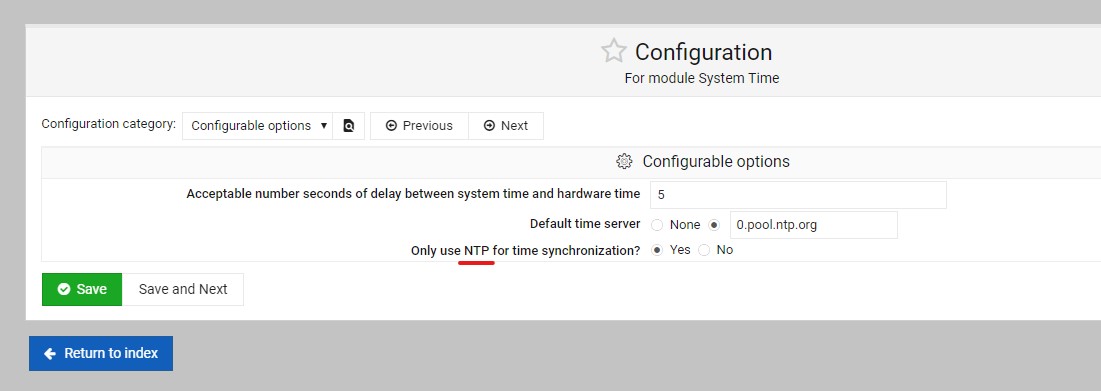

The first question was not specifically related to Virtualmin, but to Virtualmin/Webmin. In the web interface, if you visit the Webmin > Hardware > System Time section, in the third tab "Time server sync", the settings related to time synchronization can be made. If you choose to change the configuration of the module, you will get the following page where reference is made to NTP
I haven’t checked what’s going on behind the scenes in Webmin, but I wanted to make sure it’s ready to support both packages, as long as they can be installed, being interested more in NTPSEC support.

I haven’t been able to get ntpsec working with webmin, I keep forgetting to bring this up and usually just install ntp and move on, but if I read correctly ntp is on the chopping block in deb 13
Michael
In the past the same section in Webmin was modified based on a discussion initiated by me. Then I showed that the ntpdate package is deprecated and we have to take a step forward. After so many years, it’s time for that module and the whole time synchronization part to adapt to the times. The Debian team makes us choose ntpsec.

I just discovered that Webmin cannot correctly set and sync time, date and timezone. I will need to fix that.

Is timesyncd being considered added as a choice for this section?
This will only work with NTP (and some other packages) installed currently. I don’t want to replace timesyncd with NTP. OS is Debian 12.
