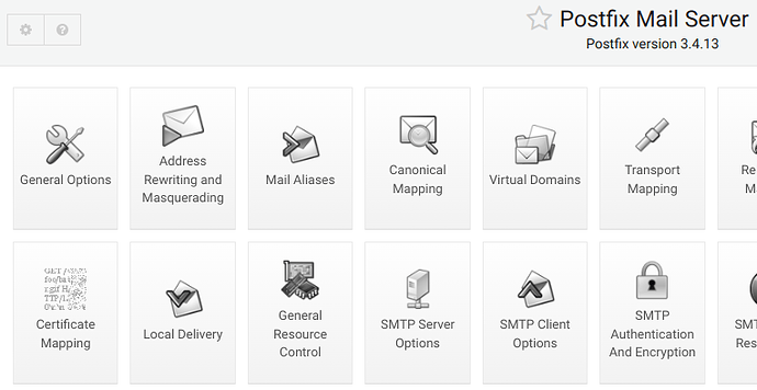

Correct server:

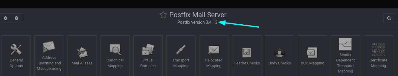

Incorrect server:
How can I get Webmin to recognise the correct installed version and give me access to the “Certificate Mapping” module?

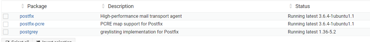

webmin shows :
but the command line shows :
and

Yep, same issue as me but just with different versions. My difference is critical because 3.3 doesn’t have SNI (Certificate Mapping), 3.4 does.

I have 3.4 on the command line and Webmin package list, but 3.3 on the Webmin Postfix configuration screen, and the 3.3 version is the one prior to SNI which doesn’t have the Certificate Mapping module. I have another almost identical server with the same OS and Webmin version, but it displays 3.4 on the command line, 3.4 on the Webmin package list and 3.4 on the Webmin configuration screen. This one has the Certificate Mapping module. And when I run apt upgrade on Postfix it says current version is installed on both servers. Somehow, on server #1, Webmin is displaying the incorrect version of Postfix, and consequently I don’t see the Certificate Mapping module.
