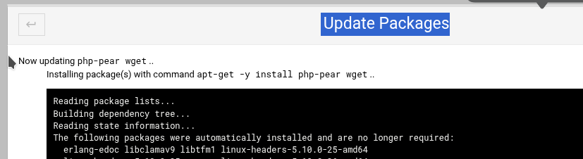

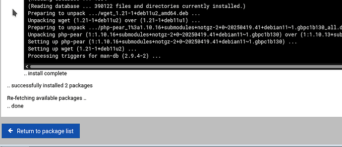

Hi.
Just an update..
today I just ran:
apt update
apt upgrade
It’s fixed this issue for me.
I did nothing except the normal update and it worked. As I said earlier, this isn’t the first time I’ve seen PHP updates get out of sync.
