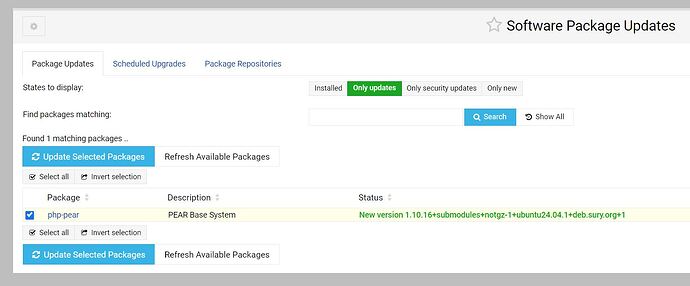

Here is what it’s trying to install:
php-pear PEAR Base System New version 1.10.16+submodules+notgz-1+ubuntu24.04.1+deb.sury.org+1

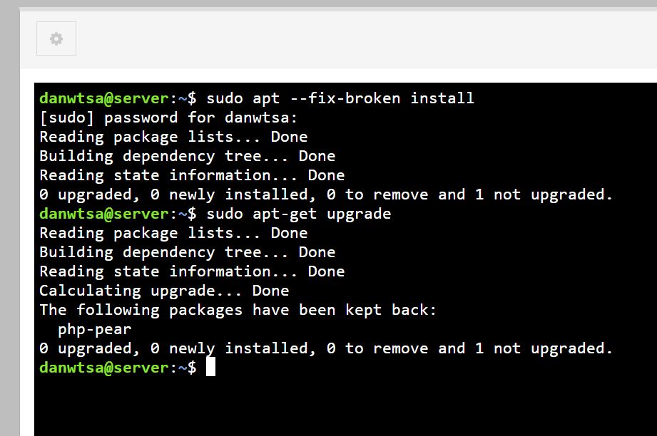

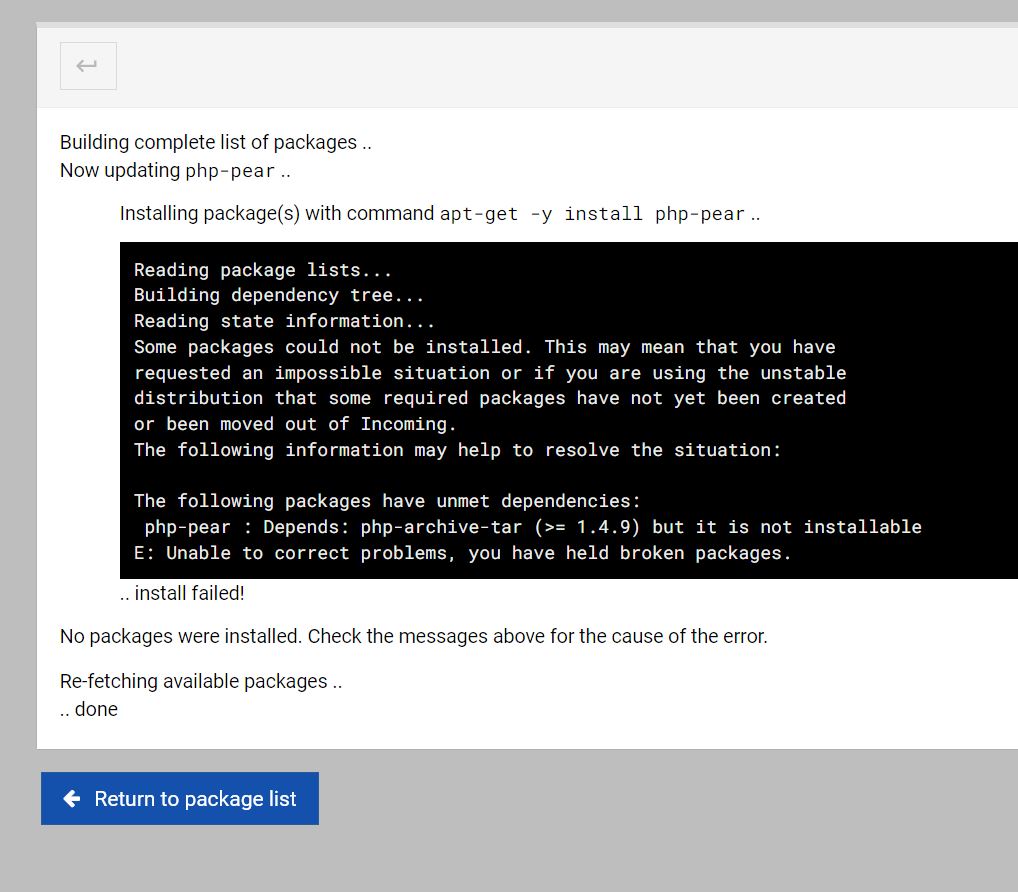

Here is the error:
The following packages have been kept back:
php-pear
0 upgraded, 0 newly installed, 0 to remove and 1 not upgraded.
The following packages have unmet dependencies:
php-pear : Depends: php-archive-tar (>= 1.4.9) but it is not installable
E: Unable to correct problems, you have held broken packages.

Maybe wait. I’ve seen it a couple times where the php updates get out of sync and some get released early before the whole tree gets fixed.
EDIT: I just ran into this. But I’m pretty sure this is an upstream package thing and will be noticed quickly.
This is a third-party package. Have you disabled the related sury repo since installing it?
If not, it’s a question/concern for the repo maintainers, as it’s a dependency issue with their packages. Sometimes there are changes that require manually removing and reinstalling a specific packages. This is most likely in cases where the OS has been upgraded since you installed packages from the third party repository.
