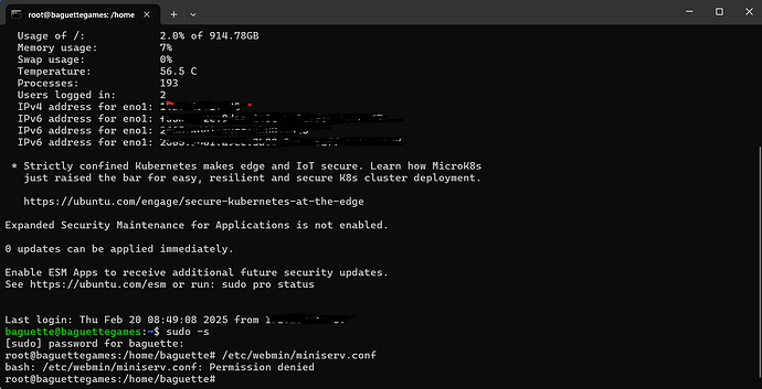

Permission denied when trying to change ip permissions through ssh
Ok type nano /etc/webmin/miniserv.conf you need to edit the file not execute it, which is what you are trying to do

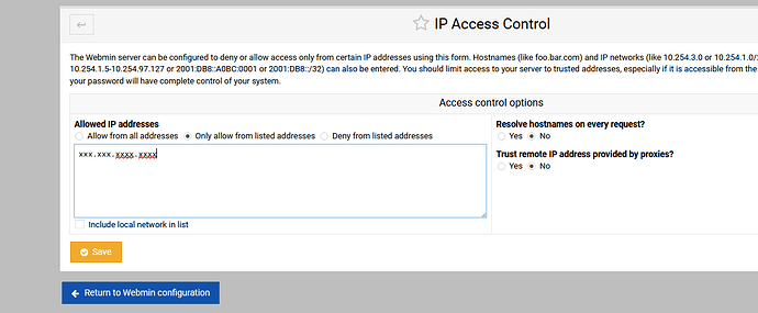

Okay, my beginning issue is that I am locked out of the webmin interface through https://localhost:10000. What should I edit to hopefully fix that? I’m thinking it’s an IP permission problem.
I’m assuming I should try something with the trust_real_ip=1?

just delete the line allow=xxx.xxx.xxx.xx, save and then restart webmin
That line is not there
I have that as 0…
It will only show is you added the IP here.
Yeah, that’s how I locked myself out I’m pretty sure

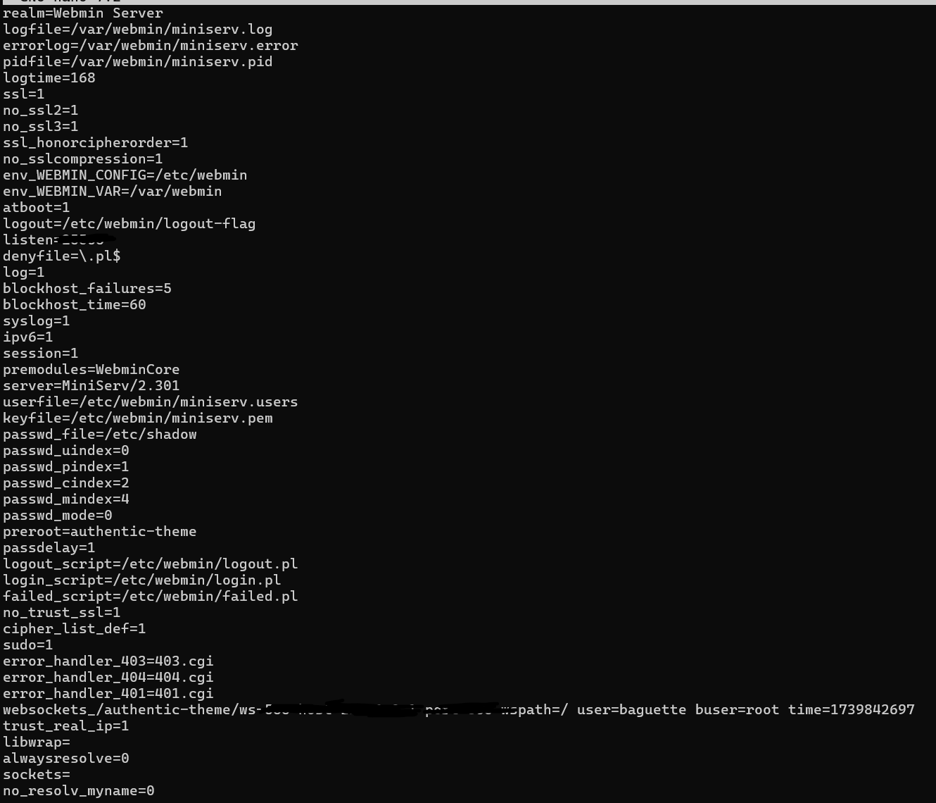

its will be at the end of file, did you go to the bottom not just whats on screen
That is everything in the file except for the port:10000 at the very top

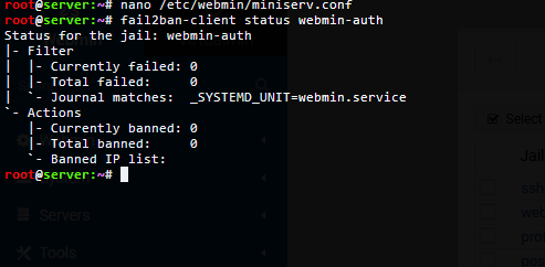

you can list the bans
fail2ban-client status webmin-auth
This did not work. It says that fail2ban isn’t installed
