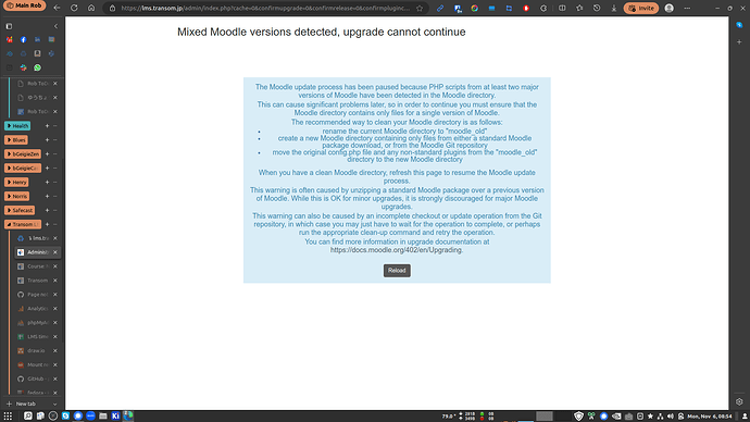

I went to the website of the installment and opened up the LMS. Moodle could not be updated… :frowning:
Now restoring the site. From backup.

LLia,
Probably, I should have reinstalled V4.2. with the script and then update to V4.3 :frowning:
Seems the script is not yet bulletproof and need some more work.
Regards,
Rob Oudendijk
It works for me pretty well! Also, I would expect the error message as you shown in the screenshot above in case the Moodle installer wasn’t updated correctly.
