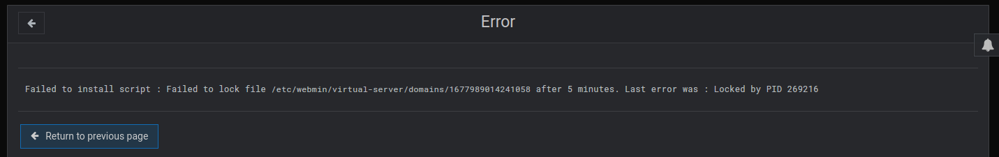

LLia,
The script came back with the below error. Site is accessible. I will restore a backup.
Regards
Rob

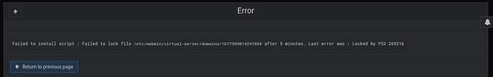

LLia,
Regards
Rob

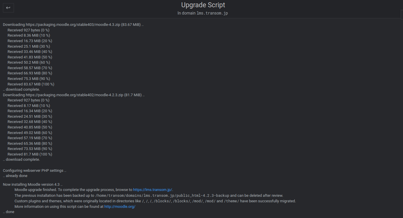

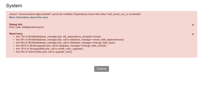

LLia,
Uninstalled Moodle,
Installed V4.2.3
Restored backup database and files from Moodle V4.2.3
Updated to V4.3 with the script and the following errors:
Finally, uninstalled again, installed V4.2.3 and restored the site.
Seems the script still has serious issues.
Regards
Rob Oudendijk

I have also seen an issue (I did not take screenshots) about an index error that needed to be deleted before the update could continue). Sorry, I do not recall details.
