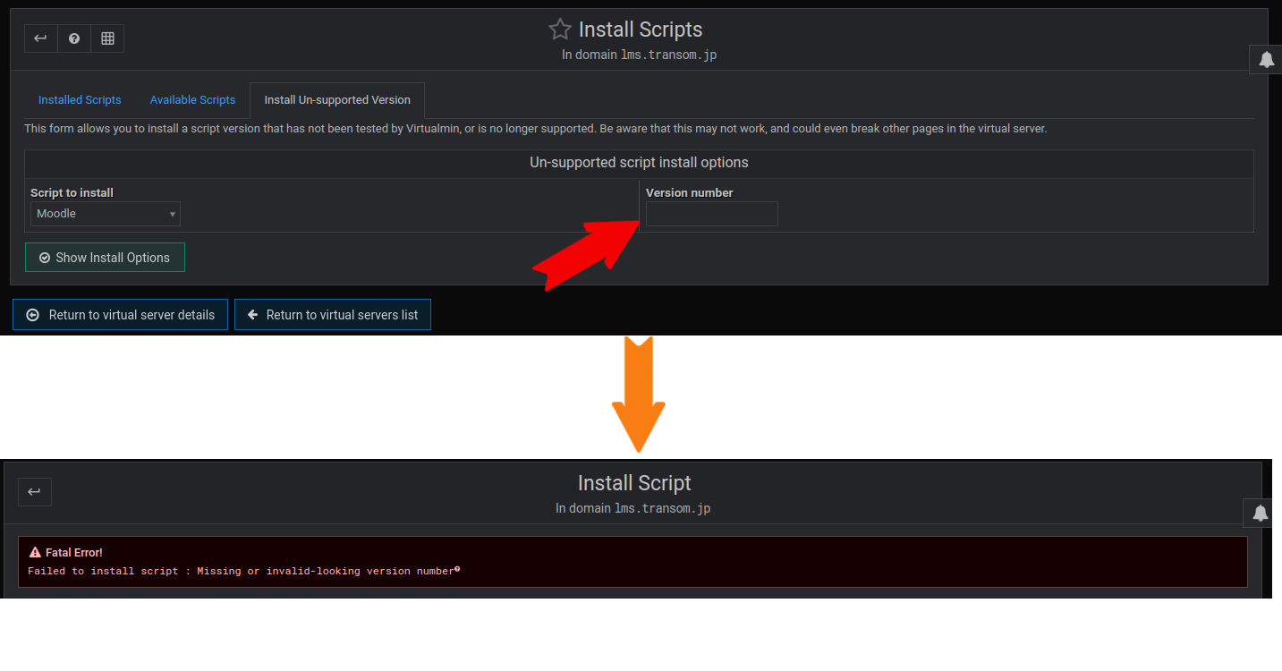

I tried to find out the version number of the scripts. But get an error.
Regards,
Rob Oudendijk

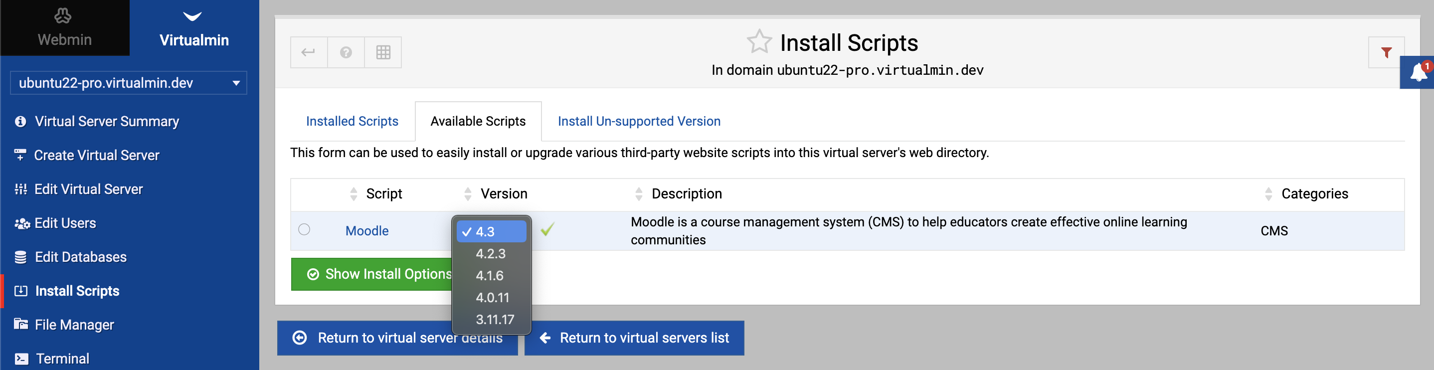

Yes, in this particular case you should see Moodle version 4.2.3 back again, e.g.:
You can however force pull latest scripts by going to Webmin ⇾ Webmin Configuration: Webmin Scheduled Functions page and manually re-run scriptlatest.pl.

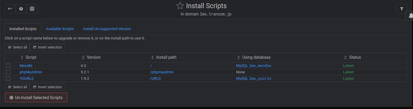

I did run V4.3 a few days ago, and it messed up the setup. I manually downgraded Moodle back to V4.2.3. The script still thinks V4.3 is installed. What do you advise me to do?
Run script V4.2.3 first and then after that update to V4.3?

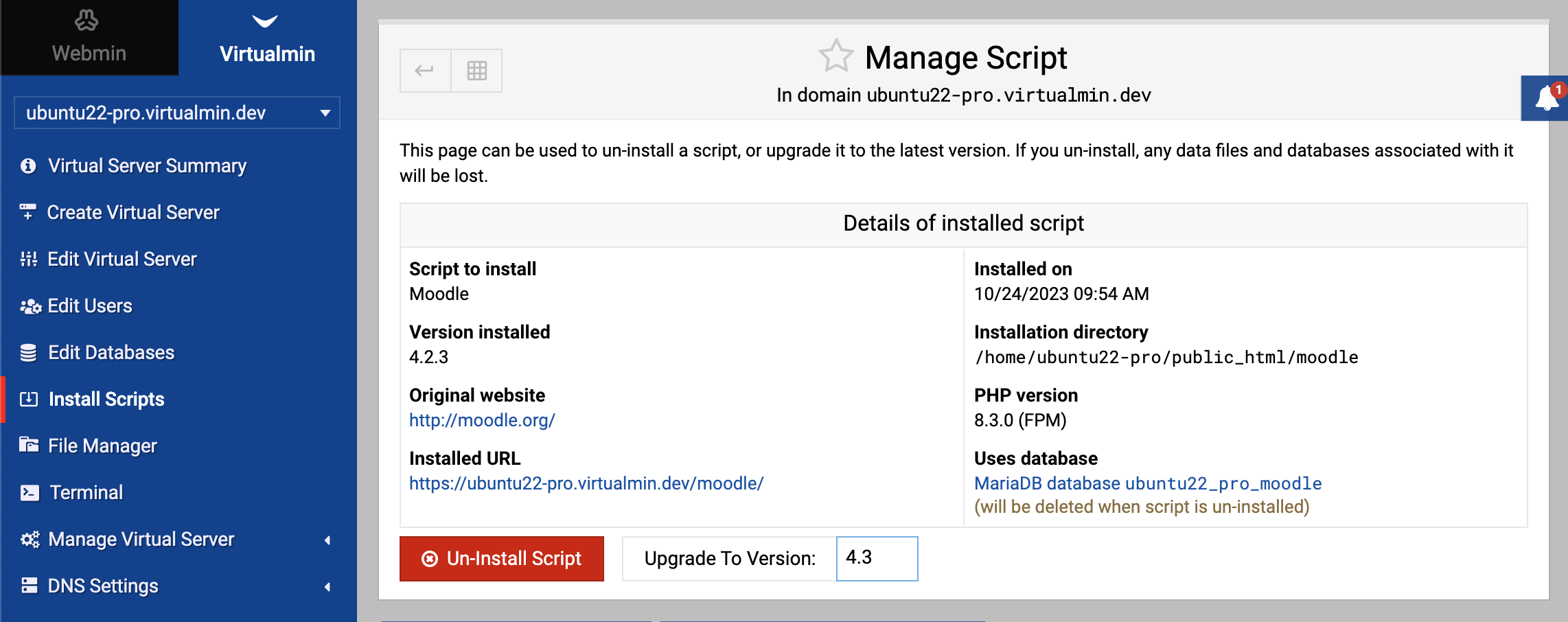

What script? Do you mean Virtualmin thinks that you still on version 4.2? If so you can just click on the Moodle script name under Installed Scripts tab and upgrade to unsupported version by entering 4.3 in the field, e.g.:
Llia,
No Virtualmin thinks I run V4.3 after I did update first with the script and after the botched update, manually downgraded to V4.2.3 by a server restore of the files.
Regards,
Rob
Now, just manually install/reinstall Moodle 4.3 as explained in my previous post.

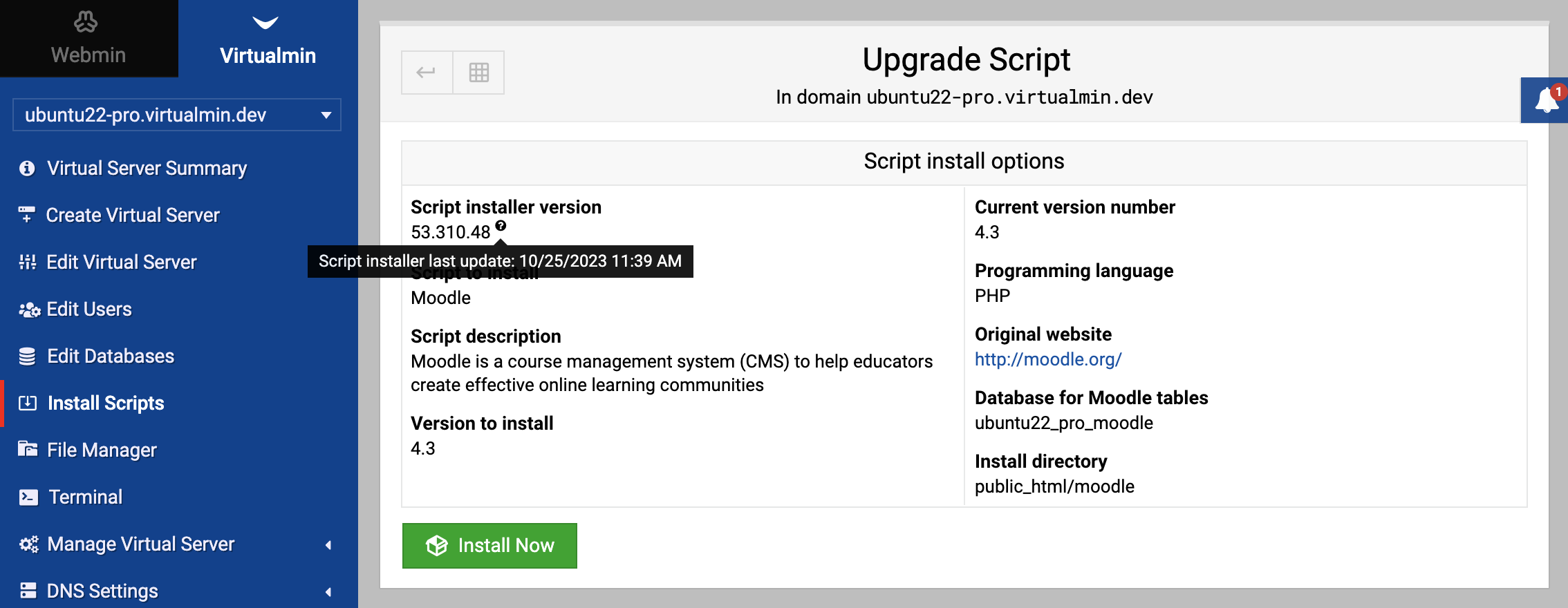

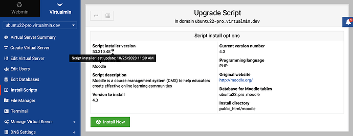

Alright, next Virtualmin release will show script version based on the script installer file timestamp.
It will make it easier to understand when script installer was updated.

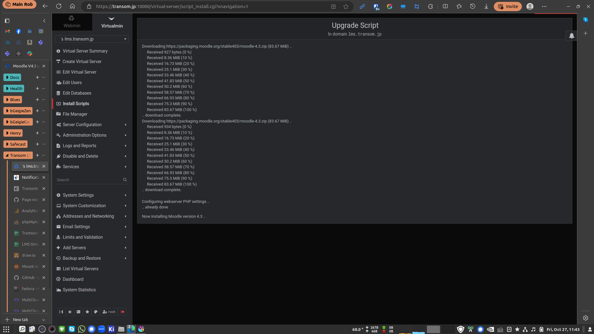

I did run the script, and it seems “frozen” for about 20 minutes. And Moodle is till on V4.2.3.
What would you recommend doing?
