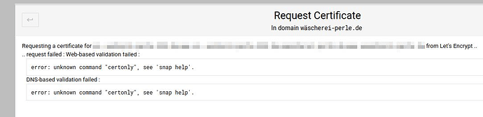

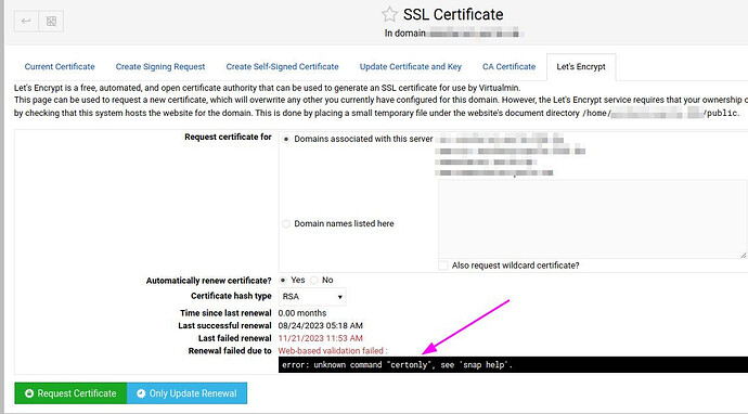

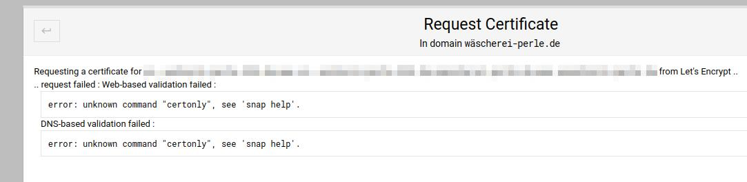

If I run letsencrypt via Virtualmin I got this:

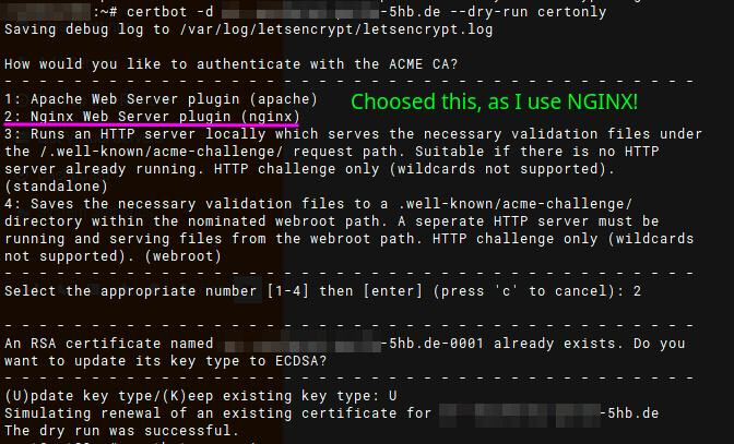

But if I run it via CLI:
certbot -d mydomain-5hb.de --dry-run certonly
It work as expected

  3. How to fix the issue Virtualmin has with the current certbot version.. (that error: unknown command "certonly", see 'snap help'. error)

Ok, triggered now the renew via GUI with this outdated 0.40.0 and got this error.
Now I remember, it was the initial error, why I switch from 0.40.0 from package manager to snap-version:
