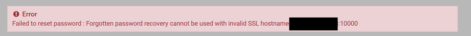

tried to go in through Virtualmin again using IP4 and port 10000 and get this odd response
it is odd because that was where the install failed “configuring SSL for the host name”
according to DO everything is working and they are as clueless as me
something is going wrong somewhere in that virtualmin-install.log but i am just not seeing the wood for the trees.
