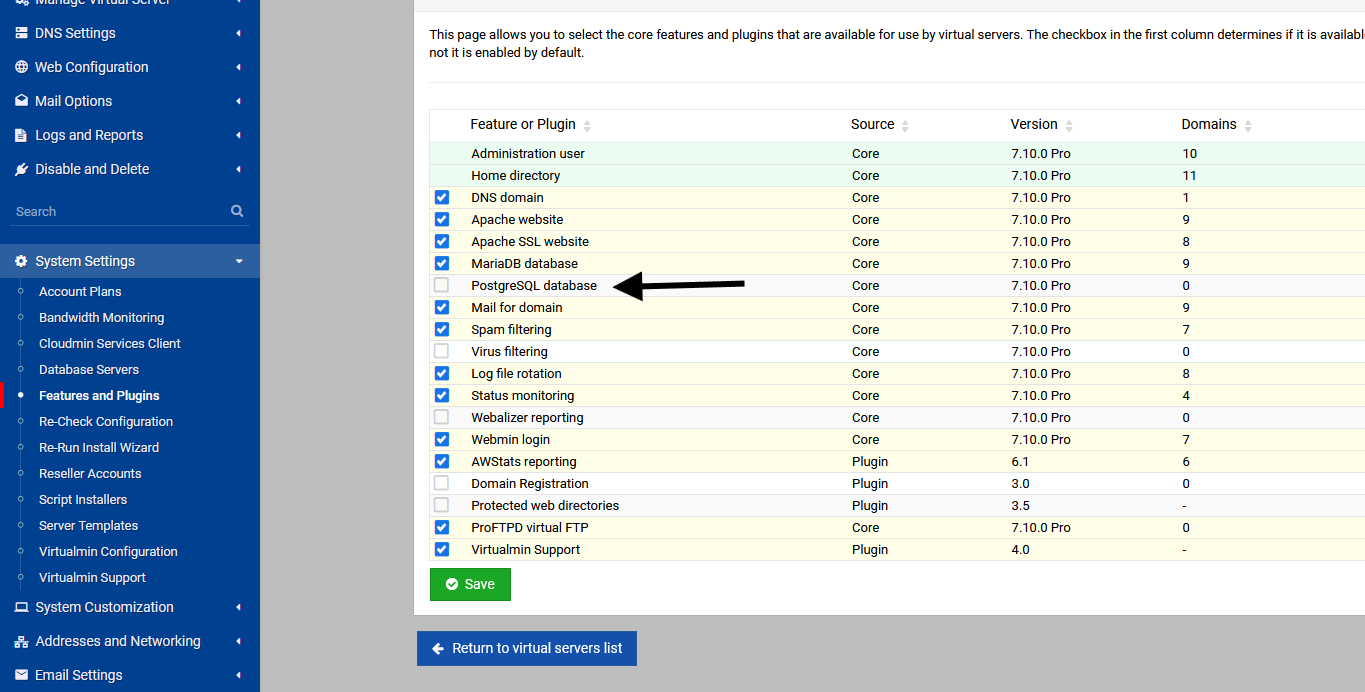

Then enable the PostgreSQL Feature in Features and Plugins.

When running the setup (a year ago) I didn’t check PostgreSQL, so now when I try to enable it in Features and Plugins it tells me that it’s not installed. I don’t even see a PostgreSQL module (I guess you mean under Webmin->Servers, I just have mySQL there) …
So the process is to install it outside of Virtualmin (command line) and it should appear as a module here ? and then I will be able to go to Features ?

And even though I did that the “PostgreSQL server module” still stays in “unused modules” and I’m not sure if I have something to do to move it up to “Webmin-Servers”, and sure enough I found it, there is a “refresh modules” button that does that !

Did you enable in virtuamin
Yes I did :slight_smile: it’s really the “Refresh modules” that did it ! The button below “Unused modules” in Webmin.
