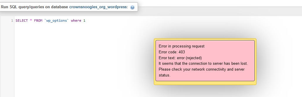

There is no WP app that doesn’t work ok. My WP installs work fine, there is no sign of any error in any of them.
My problem is with queries in PHPMyAdmin, which is running on the MariaDB instance that all my WP sites use. The errors are only happening directly in PHPMyAdmin.
Found the issue on my server, its was Wordfense, its was blocking the queries. Once I deactivated it the queries worked.

Actually the plugin is doing its job, its detecting what could be hacking of the database. A false positive I guess.
I added my ip to the whitelist and works fine now, hopefully its the issue for OP.

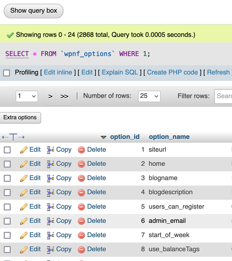

You wanna hear something a little frustrating? The problem went away by itself.
I just tried again and all queries are working from within PHPMyAdmin, including the one I screenshotted above as showing an error. I haven’t changed anything since I took that screenshot. I have no idea what’s up.
I do use wordfence, so I thought it might be the same error, but I haven’t turned wordfence off yet, and as you can see in this screenshot, the exact same query now returns results, not an error:
Weird. Nice from a user perspective, not so nice from an admin perspective… if I don’t know what the problem was, I don’t know if or how long the mysterious “self-fix” will last.

I’m going to leave this open for a while, maybe someone has some idea, or in case the problem comes right back again, or if anyone has any suggestions of other places to look for logs giving the 403 error reasons when they do happen, as that would be nice to know. Thanks to all commenters for taking an interest!
Pretty sure it’s Wordfence, add your ip in the whitelist to stop any future issues.
Wordfence may be involved, but it can’t just be Wordfence, because I had Wordfence on both then and now, and haven’t reconfigured it (or reconfigured anything at all), and I got the error then but aren’t… amn’t… er… ain’t getting it now. There’s got to be some other factor involved.
If it happens again, though, I’ll try turning WF off and report back. For the moment I’m not going to add my local network IP (I access all this over the local LAN) to Wordfence because then if it doesn’t happen again I won’t know if adding my IP to Wordfence actually helped or if it just happened not to happen again. I made that mistake a few years ago, when someone told me a good way to keep alligators away, and it did work, I haven’t seen an alligator. But ever since then I’ve walked around with a banana stuck in my ear, I’m afraid to take it out.

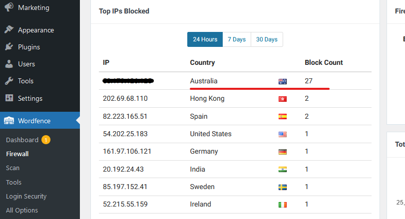

And the award goes to @stefan1959 , who was right to be persistent about it being Wordfence. It was Wordfence.
I don’t know why it’s not blocking me today, but here’s Wordfence’s log from 3 days ago, when I captured the first error screenshot, saying it was “blocked by firewall for SQL Injection in POST body: sql_query=SELECT%20*%20FROM%20%60wpnf_options%60%20WHERE%201”
This also answers the question of where there would be a log entry explaining the 403 if Apache’s error log didn’t have it. Here it is. Mental note: Remember to check Wordfence AND Apache’s logs next time.
Both mysteries solved. Thanks for your help!

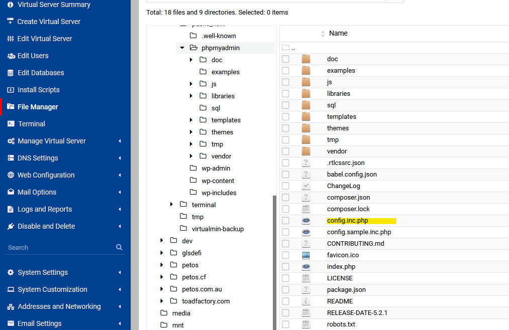

Config file is config.inc.php and its in the install directory.
I think everything is in the virtual servers phpmyadmin folder.
And I think a manual install would do the same thing.
Yes, that’s PHPMyAdmin’s .php config file, which sets internal variables used in PHP by the script.
