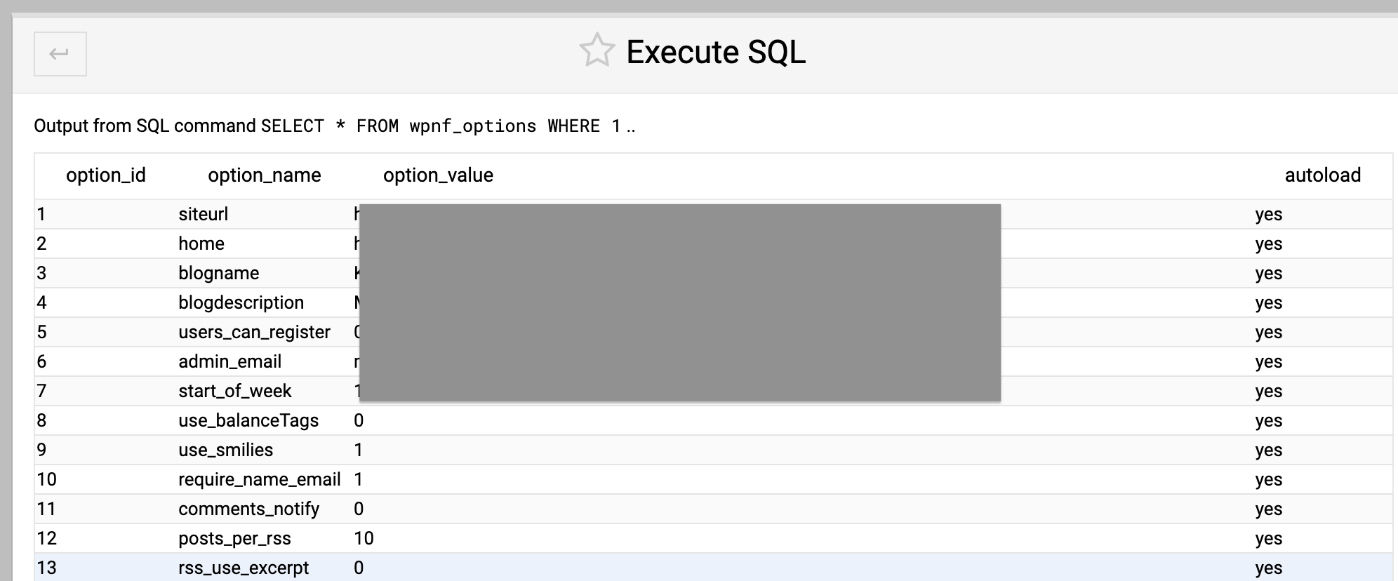

Re: running the query from webmin…
Hey, look at that! They sure do tuck that little “Execute SQL” button away where you’re not likely to see it, I even looked for it and didn’t notice it.
Yeah, queries are working from within Webmin’s “Execute SQL”, so that’s a workaround. Still not so happy, though, as PHPMyAdmin has niceties like autocomplete and generally would be much easier and less error-prone than doing it this way, especially as there are braindead-precise instructions for PHPMyAdmin (when PHPMyAdmin works) and not for doing it through Webmin, but, it does work, so, thanks for pointing that out!

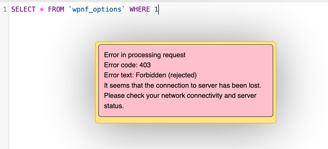

Yep, all that looks correct. And I can see the Sql button, the problem is, the second I type in a query, before I even hit “Go”, I get a 403 error popup, for any query with a where or other clause after the table name. For instance, in this image, SELECT * FROM wpnf_options works fine, SELECT * FROM wpnf_options WHERE 1 (or WHERE [anything]) gives the error.
It sure looks like some sort of permissions error. But I can’t find anything anywhere that explains it, just the one line in the access log saying that it did in fact happen (not the error log, there’s no entry in there about it at all). There’s nothing in any .htaccess or .conf file I’ve been able to find that might explain it.
